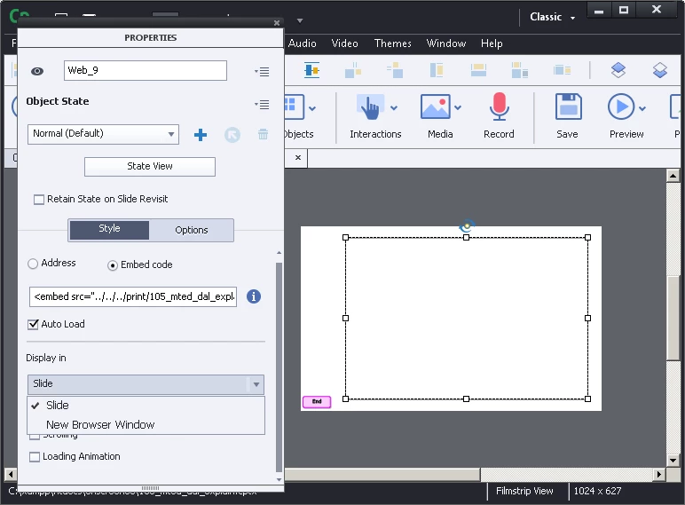

Angela,
I have had similar problems with PDF, and tried many combinations of storing the PDF in various locations.
The solution I now use is to put a Web Object on the slide, and use the Embed code option to put in a bit of HTML to open the PDF. The Web Object can be opened in the same Slide or in a New Browser Window.
This HTML I embed is
<embed src="example.pdf" width=100% height=580  type='application/pdf'>
and if the PDF is stored in a different folder I use
<embed src="../tutornotes/example.pdf" width=100% height=580  type='application/pdf'>
The height is the height of the Web Object, (minus approx 20 to allow for scrollbar stuff)
Good Luck.
Peter
