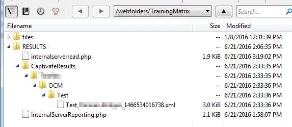

  • My testers are able to submit their quiz results successfully
  • The Organisation, Department, and Course folders populate correctly
  • The Adobe Captivate Quiz Results Analyser (ACQRA) can successfully connect to the CaptivateResults folder

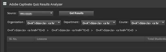

What's  going wrong:
  • Organisation, Department and Course columns in ACQRA are populated with only one option: O=A"size</a> <a href"C=D
What I think is happening:
  • ACQRA is reading the html on the webpage that the Apache Linux server produces for that webfolder and is returning snippets of HTML (i.e.: if i type in the folder path in a webbrowser and look at the source I can see where this comes from)
Here is my set up [Client names redacted].  Please note that I have tried several different ways of arranging this:
  • This is my folder structure.  Despite the help files not mentioning "internalserverread.php" at all, I have placed this file in several locations to try and get this to work.  You can see the successfully returned XML file of the tester's results, however.
  • This is where I have configured ACQRA to point to
  • This is what the results look like:
