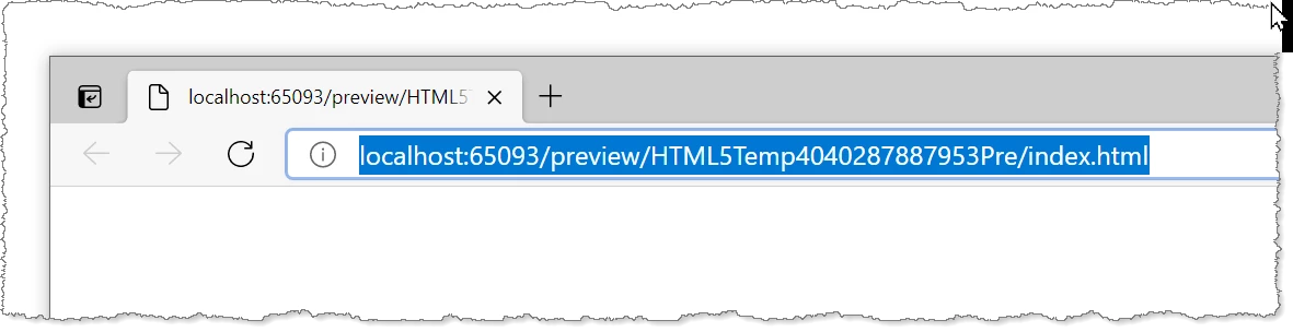

    If the content works when you Preview to HTML5, but not after you publish, my feeling is that the functionality you require is only going to be functional when the content is launched in a web server environment.
    Preview to HTML5 does create a temporary web server.  You can see that from the localhost in the browser address bar when you  are previewing.
    But if you publish to HTML5 and then launch the same content from your hard drive, that doesn't give you any web server.
    So, my suggestion is, upload your published content to either a web server or LMS and then test it from there.  You may find that it is working just fine, just as it does when previewing in HTML5.

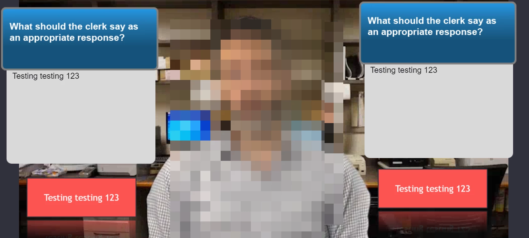

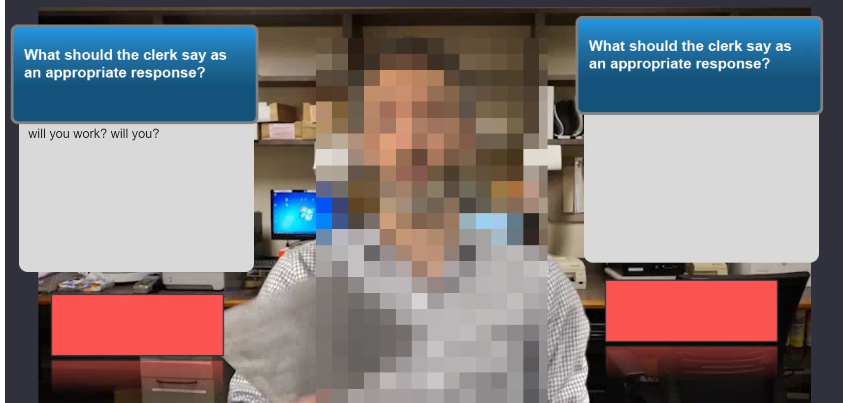

    This is just odd. I set up four objects to return the user variable from the overlay slide. Only 1 box on the interactive video slide returns the variable.
    This is from the local host, preview:
    This is from the live server:
