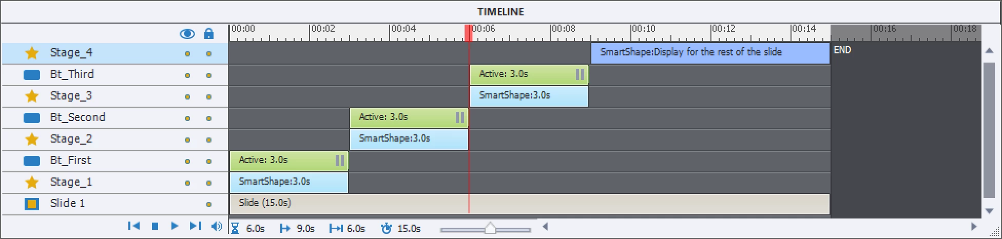

    You are using Captivate 9, right? I suspect since you talk about 'Pause after'. Since you want multiple user interactions, you need multiple interactive objects. Pause after will pause the slide for a number of seconds, then execute the next commands. I don't know how you did set up the advanced action, would have helped if you posted a screenshot of that action. However this will not give control to the user, because you will define how long the pause is. I think that an image will be better to explain a possible work flow:
    This slide has 4 stages and 3 Continue buttons (action 'Continue'), which can be aligned in exactly the same location. The pausing point of the buttons is set to the end of their timeline. First paus is at 3 seconds, second at 6 seconds etc.

    Your screenshot is pretty much what I had in my timeline, but the pause did not affect the timeline playback, only the display of the one button with the "Pause After" check. That particular button remained on screen while the slide continued through its timeline play. Though my timeline looked as your sample does here.
    In your sample, I assume that your playback will stop at 00:03 until the user clicks the object. Then another stop will occur at 00:06, and again at 00:09. Is that correct? That is the setup I used and assumed would work, yet my experience was as I described earlier.
    The only difference is that I had an intro FX applied to the button object.
