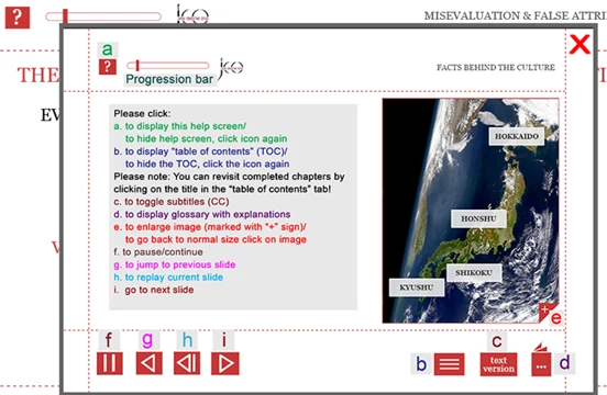

I have a customer that needs all videos and activities (eg Drag and drop) stopped while the "Help" window is opened.
The problem is that I can stop the audio and playback of the real slide but do not know how to do that with a video inside the slide.

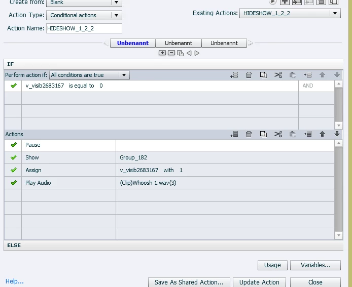

It is done through this AA:
  1. a. Is there any way to pause a video object?
  2. b. What other slides / processes are not affected by "pause"?
Thanks a lot!
