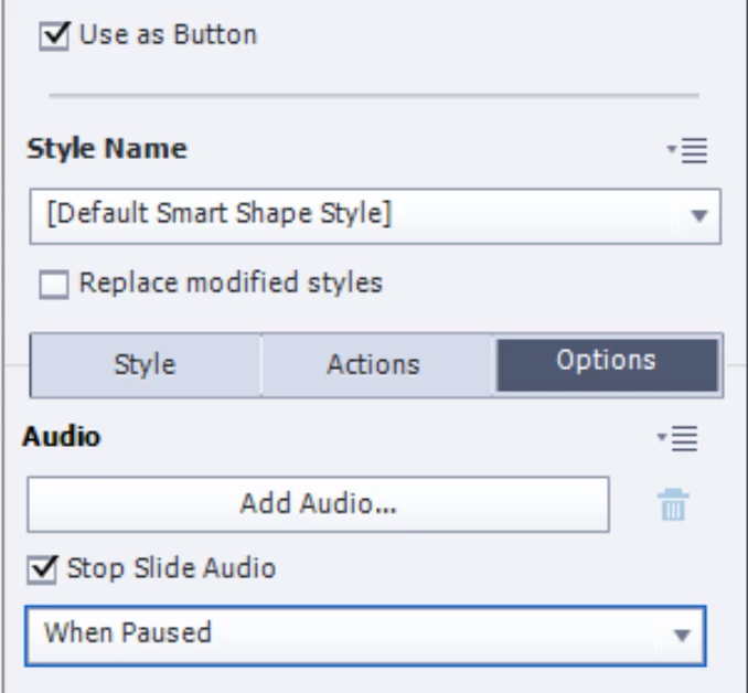

    As Rod points out it is necessary to use only slide audio in that case. Only that type of audio is synchronised with Captitvate's slide timeline. Using the commands Pause and Continue will act on all objects/effects but also on slide audio. However a pausing point of an interactive objects will only pause slide audio if you do activate that in the Options tab:

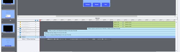

    Which solution did you use? I just now see your timeline screenshot, was not there when I tried to supplement some ideas to Rod's answer. Screenshot is bit fuzzy and small. The three buttons appear only after the end of the audio clip which is indeed slide audio. It is a fluid boxes project.
    My question is meant for other users struggling with the same problem: which solution?

    Thank you Rod, I recorded the audio using the record tab on the menu bar at the top.   Ithen named that clip in my library and called it slide 5 for example.  have then put a third button on the screen which animates at the end of the slide along with next and back. if clicked will play slide 5 audio again and I have de slected coninue movie to hold it all in place as it were.
    I hope this all makes sense, I tried to create buttons to pause and then one to contine.  I bandoed that as it casued me all sorts of problems with the timeline and in any event it just did not do what I thought it would.  I dont know if this picture will help?
    I appreciate your help, I have so much to learn on this
