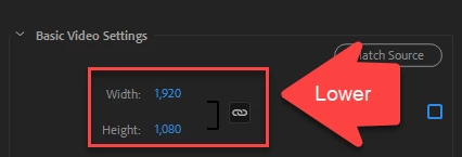

With regards to your videos, I would rather stream a lower quality video that loads quickly than have my users stair at a loading graphic for what will seem like an eternity to them. Run your videos through Adobe Media encoder to resize them down to just what you need for your slide size.

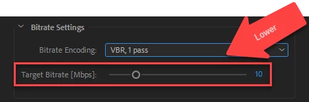

More importantly, set the bandwidth in the re-encoding process to something as low as you can get away with for a balance between quality and what your network can handle. Remember that network bandwidth changes from moment to moment.
