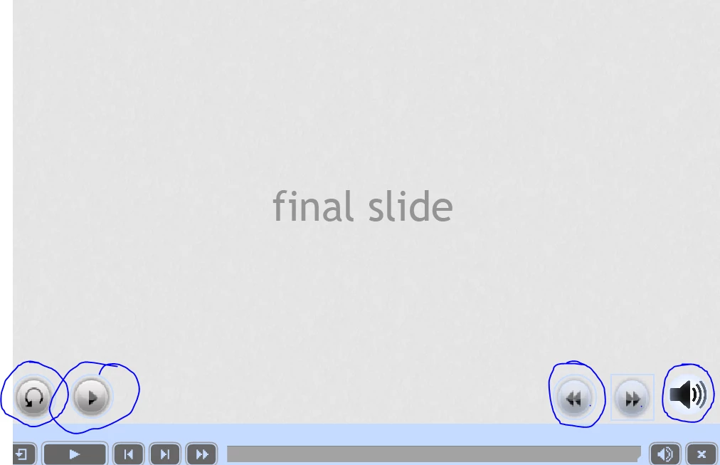

i want to create a play,pause,replay,next and previous button on each and every single slide.i put it(play,pause,replay,next and previous) on the first slide of a project and set its timing  on  the rest of the project.
its work finely when it will reach final frame count  of the project. after  i click  those  buttons(replay,previous,play,pause) it will not work.

    It's because you are at the end of the timeline, there is nothing to play or pause, there are no frames left.

    i want to replay final slide.is there any way to replay last slide when frame count is complete at entire project?

    Is the HTML5 or SWF? Even if you replay it, the slide is only 3 seconds long and will be right back at the end.

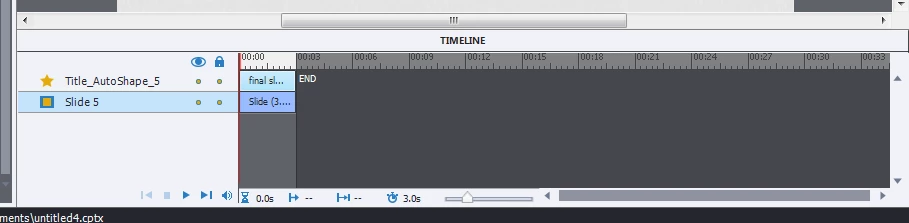

    October 25, 2016
    Where are the pausing points? Can you post a screenshot of the timeline, please?
    Which version are you using (exact version number), it looks like 7 or earlier?
    October 25, 2016
    i use captivate 9 version.pause button is inside the play button(state view).
    Lilybiri
    October 25, 2016
    Sorry was not clear enough. I wanted to see the timeline of the first slide where all those buttons are located.
