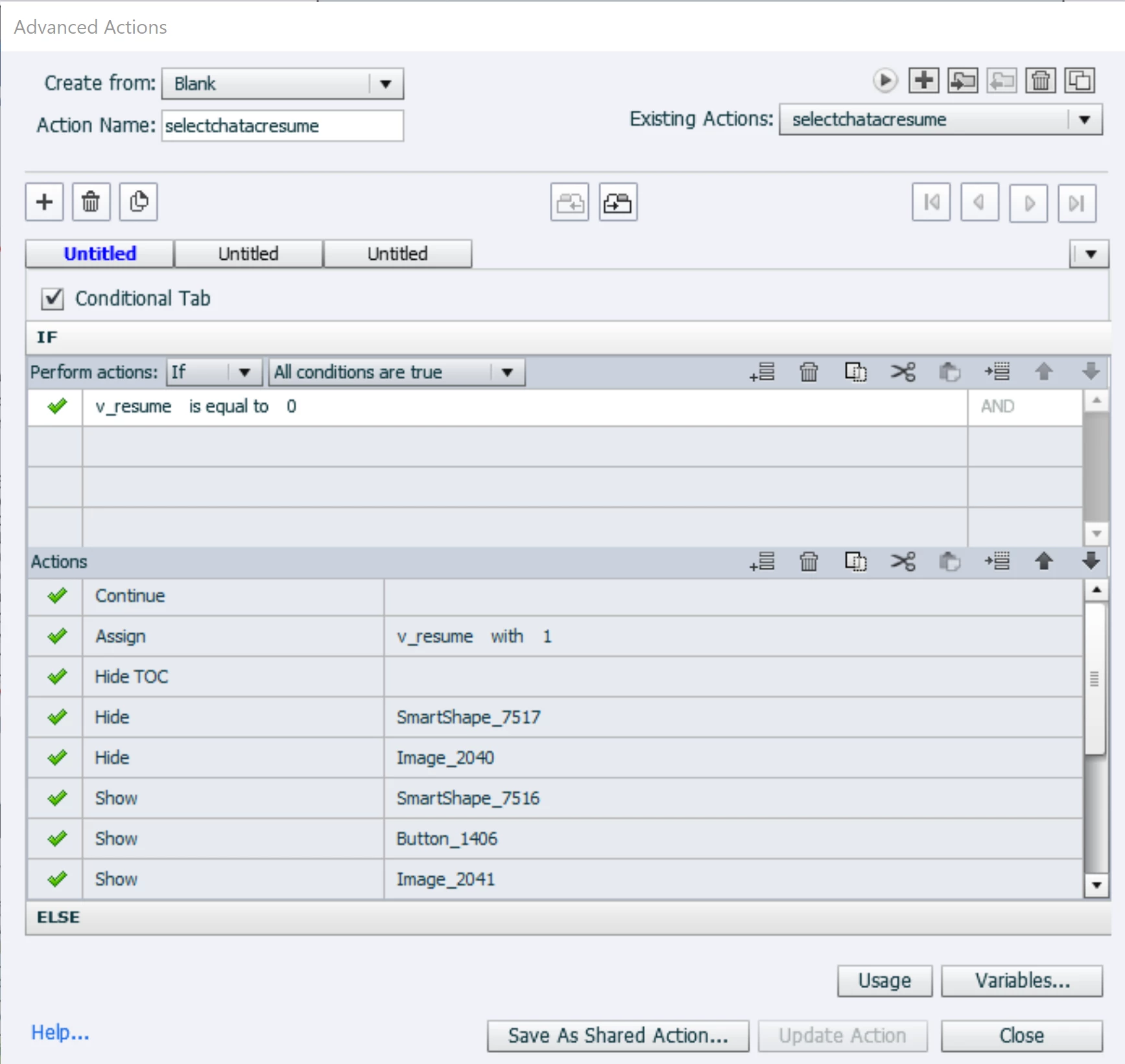

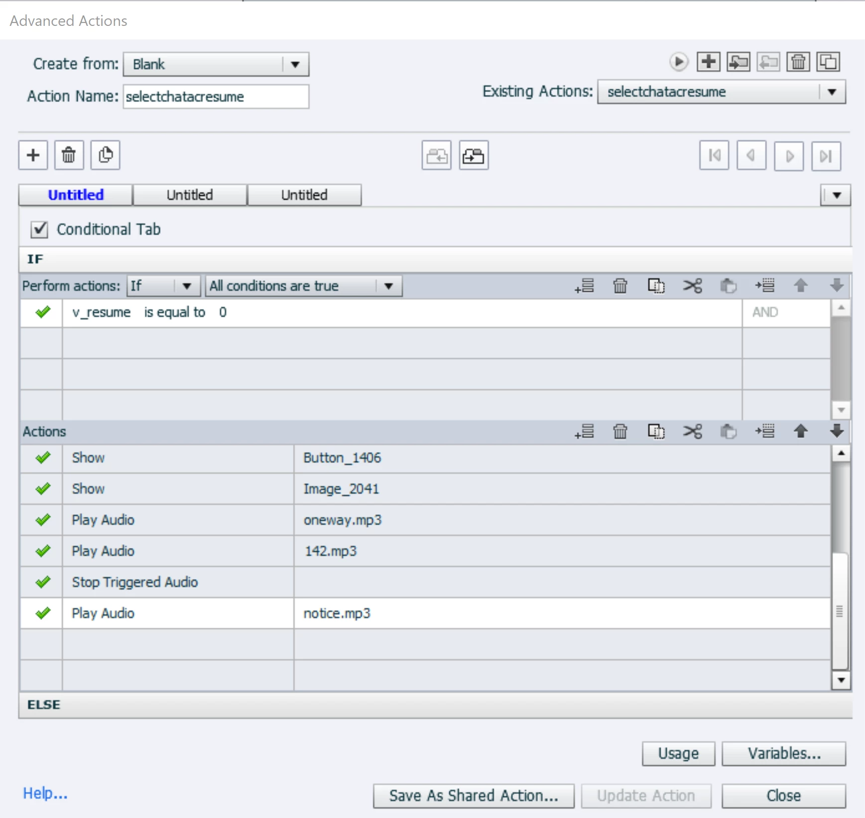

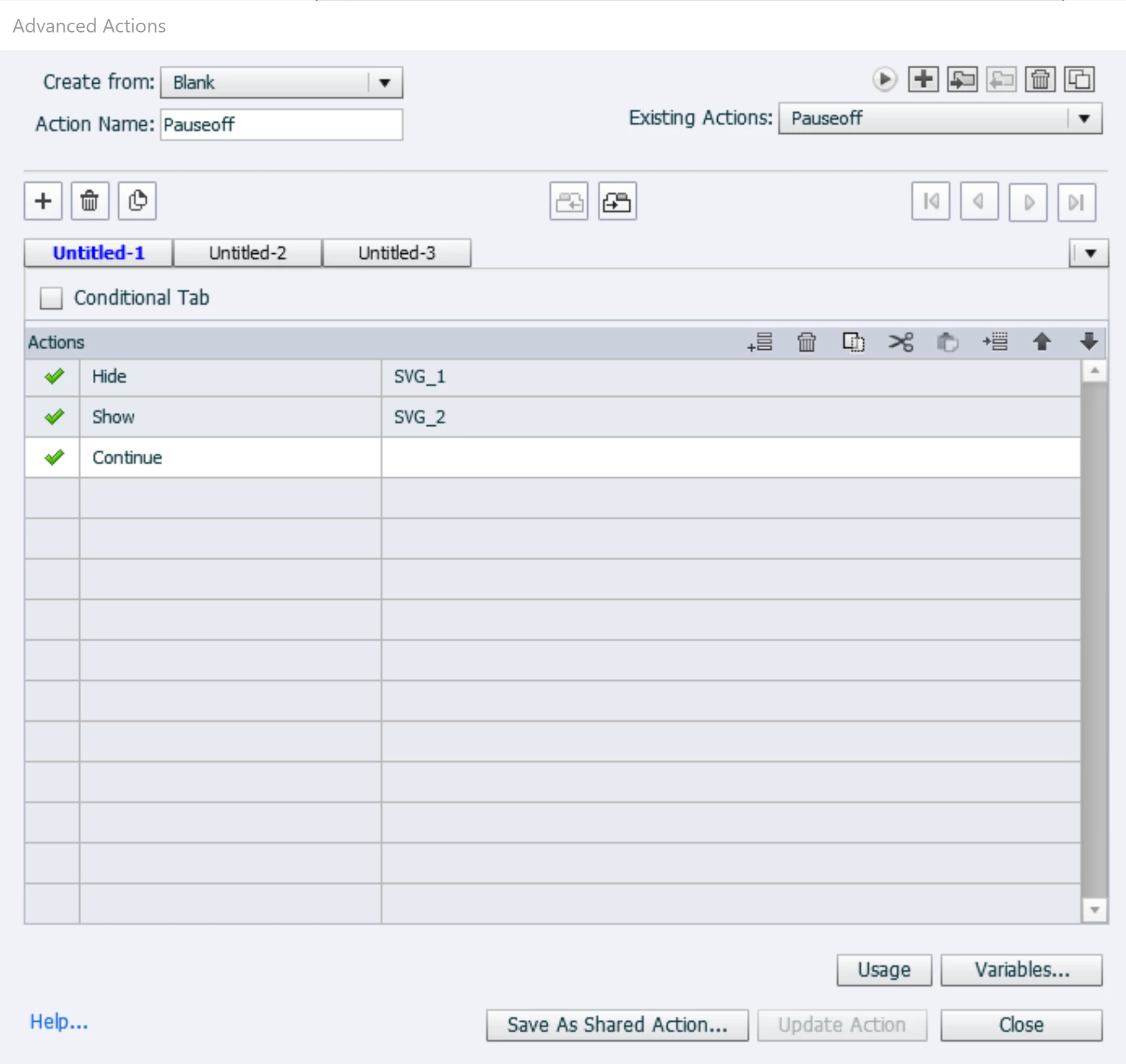

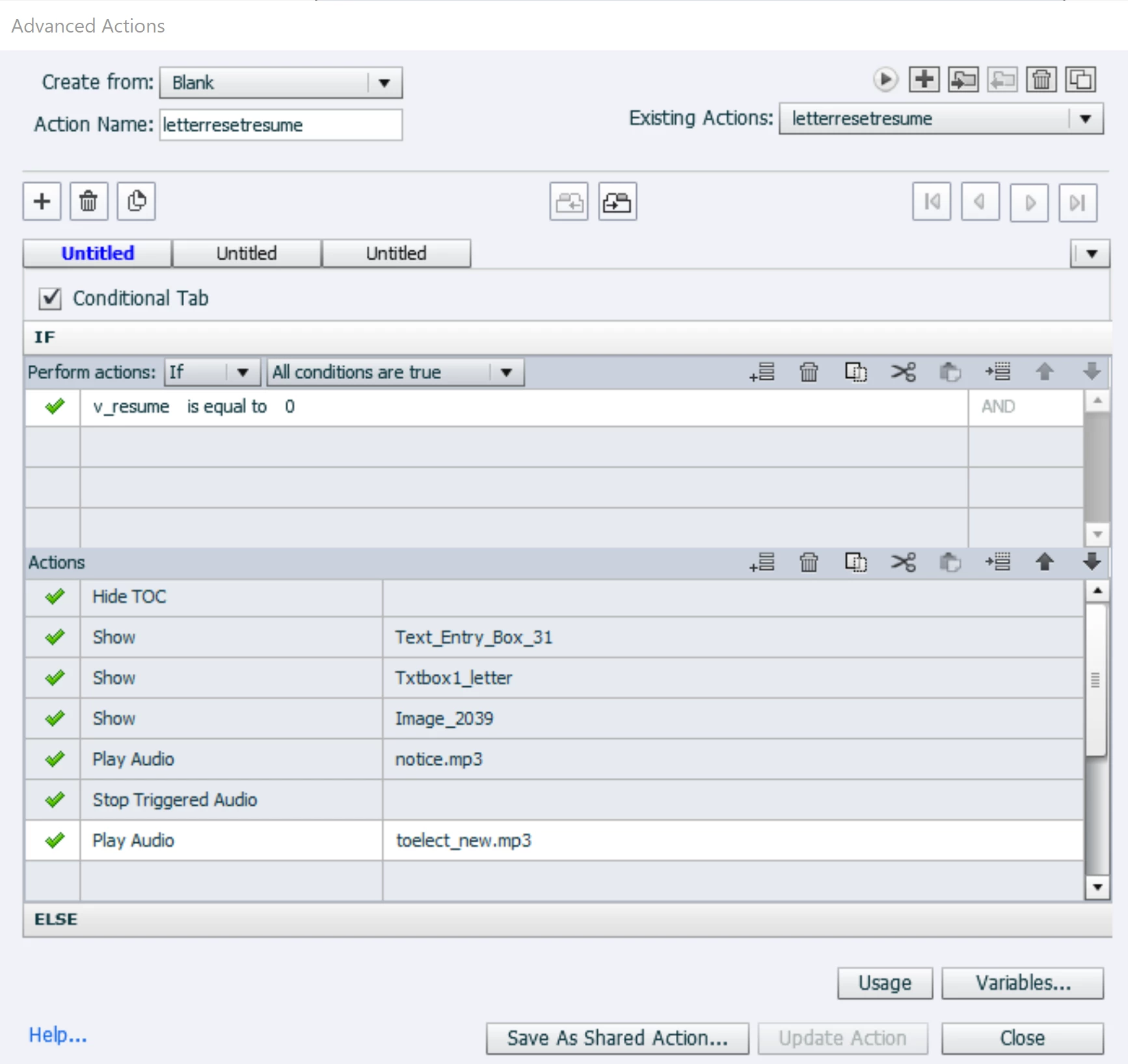

    • The buttons are on the first slide timed for the rest of the project and they work on only slides thahaveas one image and one audio.
    I have attached two screenshots that you asked for, and how the pauseon and pauseoff actions are triggered.

    Is it possible to insert some screenshots from the setup of a slide (including Timeline panel) and of the used advanced (or shared) actions? Actionscript is no longer possible, since output will be exclusively HTML5. I suspect the commands 'Play Audio' will be in the advanced a ctions, and audio started by that command cannot be stopped except by the command 'Stop Triggered Audio' or by using 'Play Audio' with another targeted clip.
