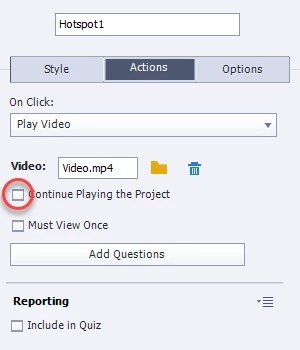

If you have additional hotspots at the same location on the timeline, make sure your Play Video hotspot has Continue Playing the Project unselected. If you have checked Continue Playing the Project, the slide will continue to play beyond the location of the hotspots on the timeline and the other hotspots will not be accessible.

Thank you so much for you reply Paul. That's exactly what it was! All working Ok now.
