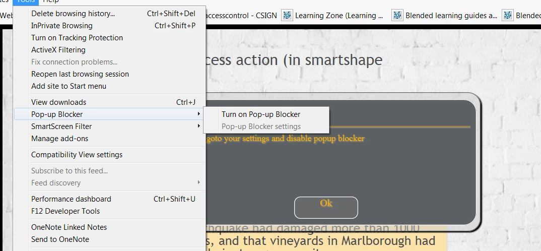

tinawiltin
Sep 20, 2017 10:43 PM UTC
Hi Lilybiri
When you refer to 'awry in your setup' are you meaning the captivate install itself? Or some other aspect of my computer setup?
I've now produced a test module just a couple of screens with a smart shape as a button with an action 'On success open URL or file'
and  a hyperlink "Open a file' and then pasted in the url that the pdf file was sitting at.
Even when I run preview as project (not loaded into our LMS) I still get this pop-up blocker warning. As you can see from the screen shot below the pop up blocker is not on

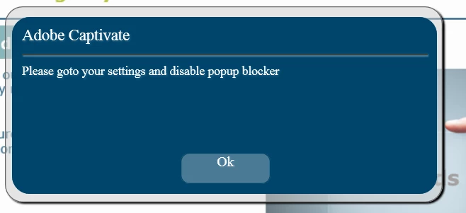

tinawiltin
Sep 19, 2017 3:39 AM UTC
Here's a screen shot of the message
RodWard
Sep 19, 2017 3:53 AM UTC
That looks like a message that is generated from the Captivate project itself, rather than the browser. It might be invoked by an Advanced Action.
I suggest you go to Project > Advanced Actions and look through the Advanced Actions listed as used in the project and see if there is one that is executing some JavaScript to show an alert box.  If you find one, check the Usage to find which slide it is used on.
tinawiltin
Sep 19, 2017 4:25 AM UTC
I'll check that Rod but this issue is now happening in at least three of our modules and I know for sure that two of them do not have a JavaScript command to show an alert box. The link has been put in two different ways in two different modules:
1) Smart shape as a button with an action 'On success open URL or file'
and
2) as a hyperlink "Open a file' and then pasted in the url that the file was sitting at
and we are getting the same message.
I agree it does look like a Captivate generated message and the actual colour changes according to the skin settings that we have chosen.
