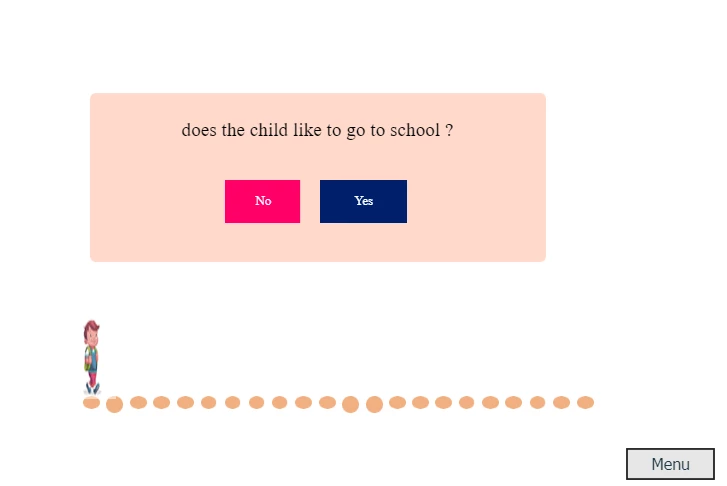

I am working on a slide that involves a series of questions. The user has to answer Yes or No to the question. there is an image of a child that moves one step further if the user answers  Yes to the question and does not move if answered No.
screenshot:
I am moving this image by creating a custom motion effect that moves the image one step further. here is the detail in this blog.

The menu button in the slide takes the user to the custom Table of content slide. suppose the user in the 8th question which means the image is 8th step forward. if the user goes to the table of the content slide and returns to the same slide, the slide will resume from where it was left off. I did this with reading blogs on Micro-navigation.  But the image of a child does not in the step where it was left off.
Everything is fine but the image comes to the first step that is the problem.

    Effects are reset automatically when you leave the slide and re-enter it. You didn't mention in the first quesstion that this could happen.
    In that case it is not a good idea to use motion effects. I would replace it by a multistate object, where the image moves one step further in each step (will be without visible movement). You can use shortcut keys to do so: SHIFT-Right key will move the image 10px to the right (you can find those shortcut keys also on my blog). You'll need as many states as you have steps.
    Instead of applying the custom effect with an advanced action, you'll use the 'Go to Next State' command on a correct question. Make sure that you activate the option 'Retain state when....' in the Properties panel of the multistate object.
