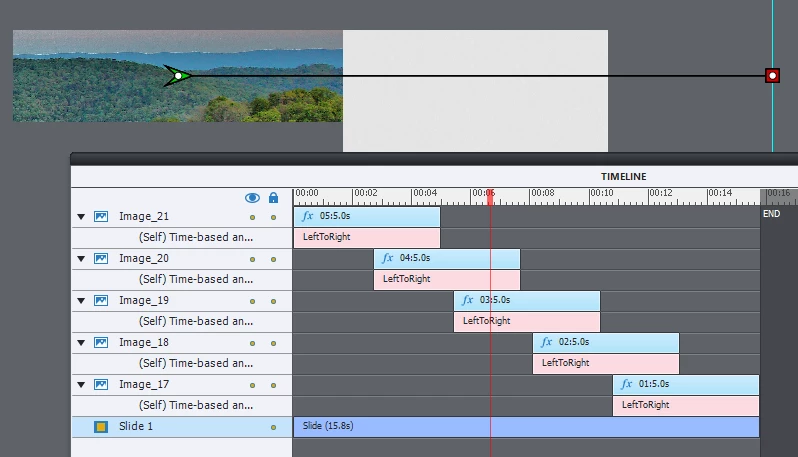

I can think of two potential ways to do what you want within Captivate’s limitations.
1) Since you want the maximum amount of time to show the image on the slide, you could size the image so the width was exactly the same as the left edge of the stage to the right side of the slide. Then setup a LeftToRight Motion Path so when the motion ends the left side of the image is touching the left side of the slide. It’s not ideal because then you’re limited to the size of the image and likely a reduced speed of animation than you would want in both cases.
2) Tile the image into multiple pieces and then stagger the animation for each piece so it appears as one single image when the slide is playing. This is going to take a bit of fidgeting regarding the best size of the tiles, where you set the end point of the animation, and when each piece starts moving. There is also the potential for the animation to not quite play correctly so you would end up with gaps or overlap between the pieces as well.
The image below shows the animations playing and the two images being seamed together so you can't tell that it's two images sliding across the top of the slide.
Granted, neither option is the best, but at least you have some options.  =^ )

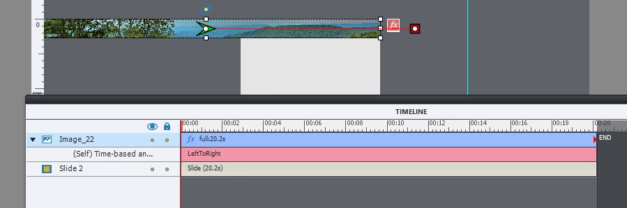

abeardsl23
December 8, 2016
Thank you so much, Michael!  This is very helpful.  However, I've already submitted my Case Study, and in the end, I just fidgeted with the length of time of the motion path, and that seemed to do the trick!
In the future, I think another option, would be to have another (Foreground) image with a right to left motion path to MIMIC longer perceived motion.  I tested this with my Case Study afterward, and it worked rather nicely, but went beyond the scope of my original case study.
