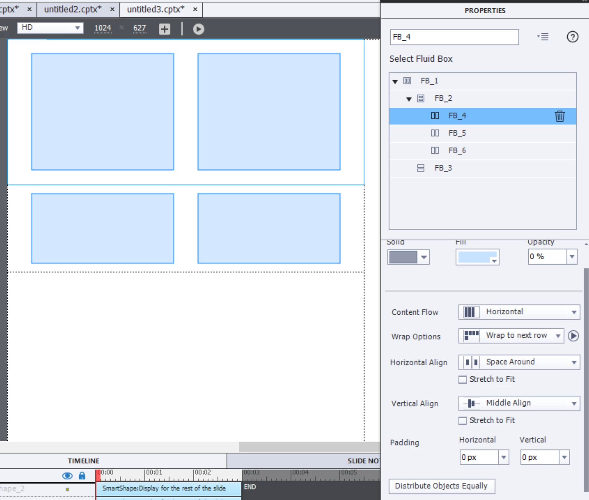

    I just created this example, you'll see the Properties for one of the Fluid box. I kept the Maintain Aspect ratio for the shapes. I set up first the shapes in the middle fluid box: duplicate the first shape and than set up the fluid box as in the Properties panel. I also used Distribute button. When copied to the top fluid box, set up the same way they'll look identical to the first fluid box; but when clicking the Distribute button again, the height will increase. You can check the % of their size relative to the fluid box in the Position Properties, but only one dimension can be set there depending on fluid box having Horizontal or Vertical flow.

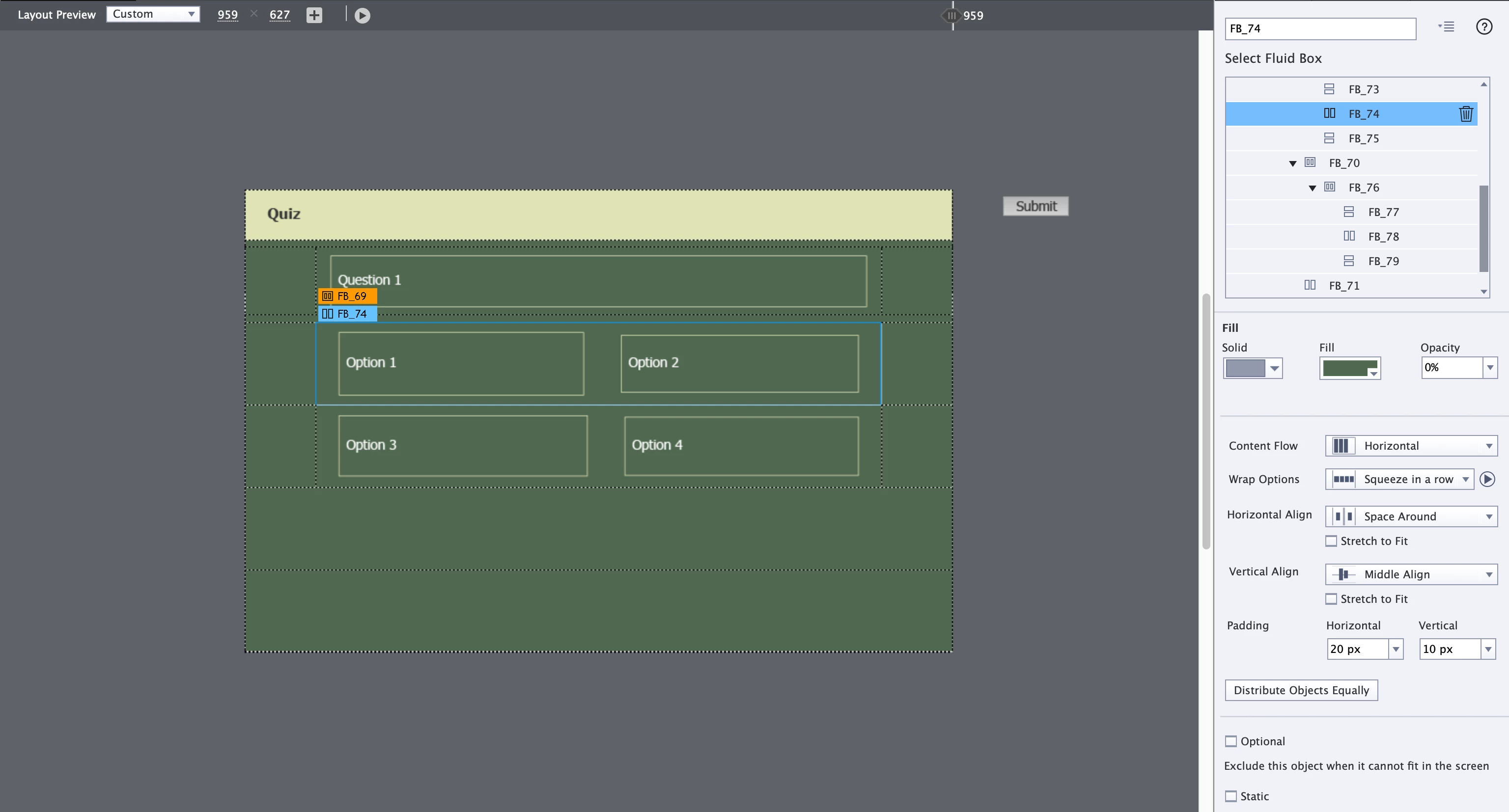

    As requested, I've attached a screeshot.
    The goal is for equal space between all shapes, all shapes to have the same height, and all edges to align.

    That screenshot shows equally spaced shapes. As for the height, it cannot be set up in Position Properties for horizontal flow fluid boxes. That is the reason I activated Space Around which will automatically add padding both horizontally and vertically. You could also play with the padding, which is in px but that is more of a trial and error. Make sure to check the result in other resolutions using the arrow at the top of the screen.
    To have identical shapes in another fluid box, make sure both fluid boxes have the same height (% in the Position Properties) and similar setup as in the screenshot. If the height is different, copy/paste the shapes but do not use Distribute objects button.
