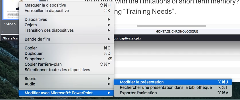

I have tried to move the PPT source of my project on my desktop, I have asked Captivate to modify the project with PPT (see 1st screenshot).
Captivate created a file "CaptivateTempPPT" that I could modify, but it is not my original file.

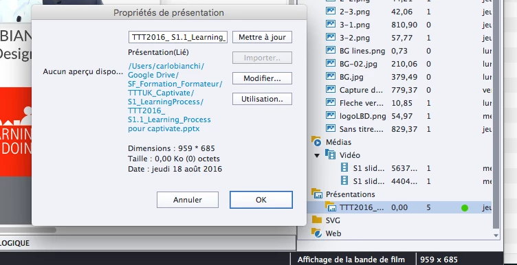

If I look in the bibliotheque, I still see the link with my original file PPT that is still on my google drive (see second screenshot)
But, how can this help me to publish correctly ?
