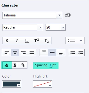

In the character block you have the ability to add a symbol and play with spacing.
I personally prefer to use ALT commands to enter symbols such as alt-138  for  è

The spacing part I referenced in the character block is to increase the spacing between lines of text.
If that is not enough to provide the whitespace you need for readability - is there a reason you cannot simply hit the enter key a second time between paragraphs?
