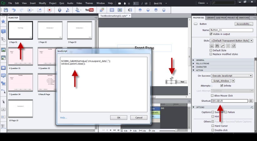

    To overcome this limitation, I found a solution on the client side that solves the “frozen quiz” problem. I tested a SCORM function that allows resetting the bookmark recorded in Skillport, and that works well.
    On the first slide of a Captivate file, I added the following JavaScript code on a transparent button. I configured a hot key to call the JavaScript code.
    SCORM_CallLMSSetValue('cmi.suspend_data','');
    window.parent.close();
    If the quiz of a learner is completely frozen, he would have to go back to the first slide, and press the ALT + CTRL + R keys to reset the Skillport bookmark.

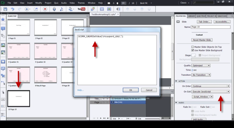

    On the last slide, I added the following JavaScript code on the On Exit event:
    If a learner exits the course while on the last slide, the bookmark will be reset. If the learner opens up the course once again, it will display the first slide.
    As a preventive measure, all courses mounted in Captivate and hosted on Skillport should have this feature. This would prevent having to generate a great amount of Skillport course codes in each update involving the addition or the deletion of pages.

    SCORM_CallLMSSetValue('cmi.suspend_data','') added on the first Captivate slide
    SCORM_CallLMSSetValue('cmi.suspend_data','') added on the last Captivate slide
