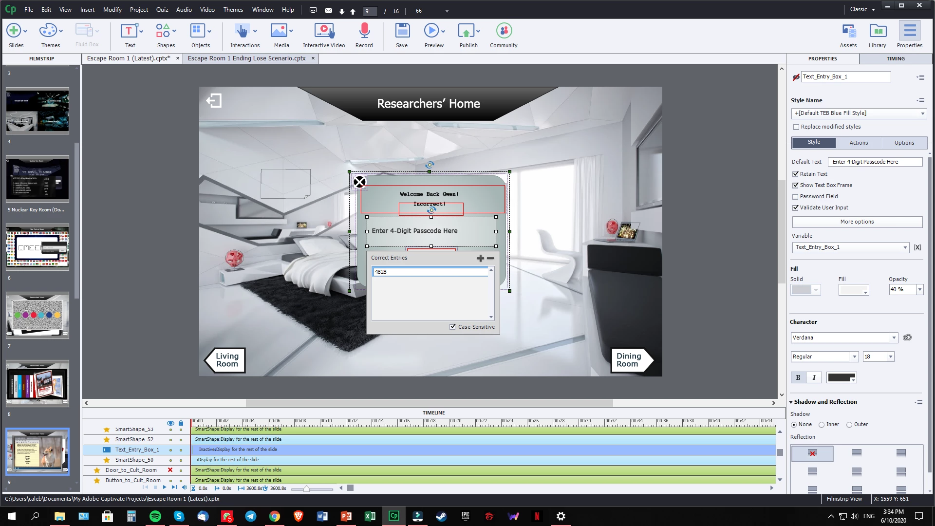

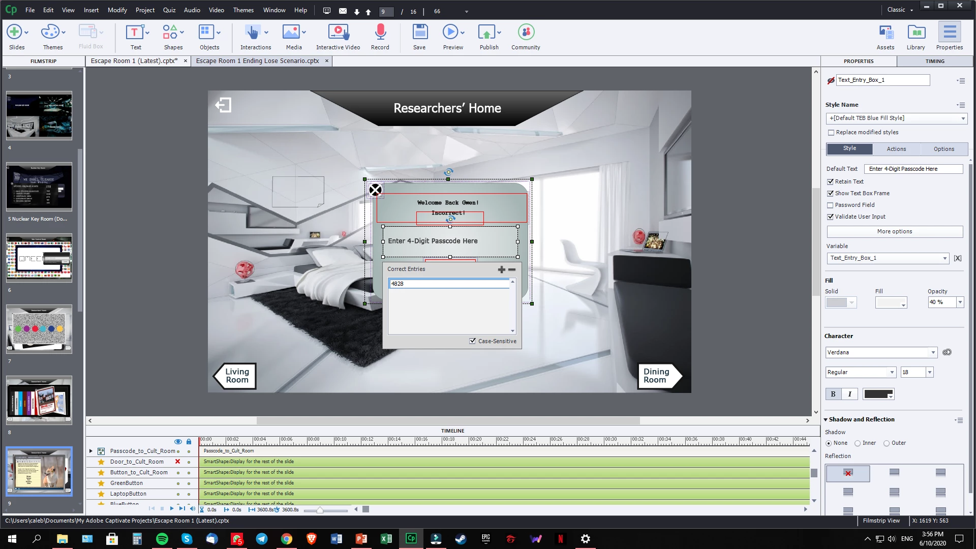

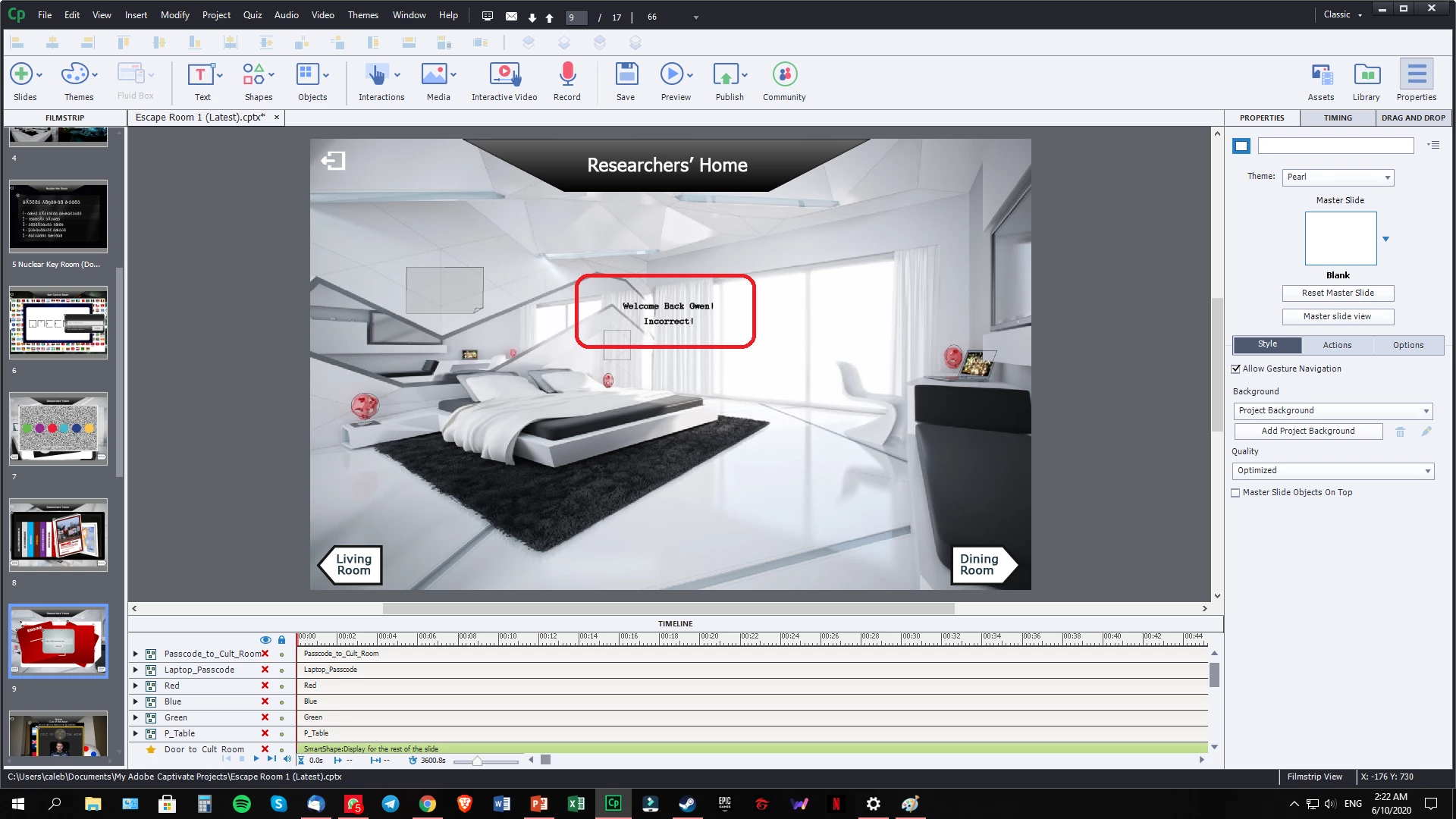

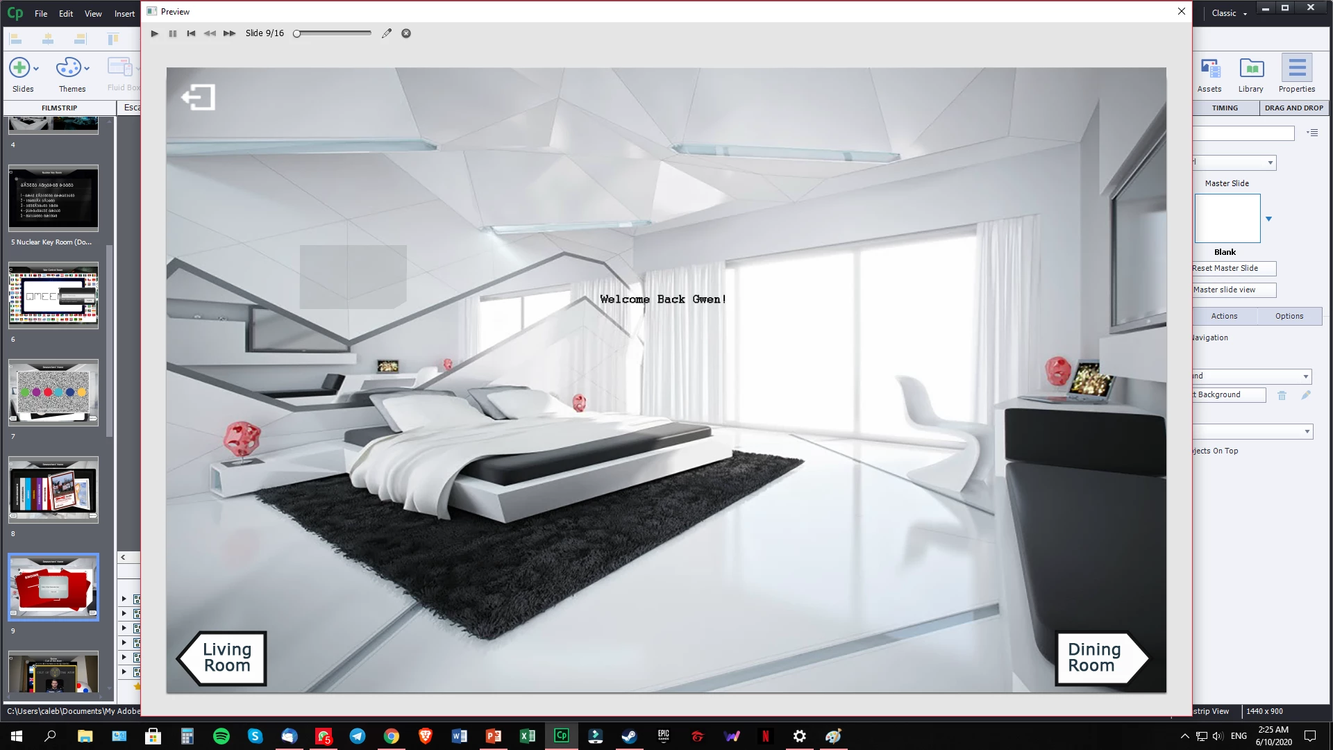

I came across a simple but weird problem as I was making text entry box passcodes for the Escape Room game and I am encountering this problem with some of the Success and Failure Captions. Where they sometimes do not disappear at all, even when I choose to hide them both in output and in the slide itself. These success/failure captions are supposed to only show after the player has tried to enter a password in the text entry box and click enter. However, it consistently shows itself, even if there is no interaction with the entry box nor input of any answers at all.

    1. I cannot see the pausing point of the Text Entry Box on the Timeline. The slide duration is very big, where do you have the pausing point?
    2. Is the Text Entry Box validated? If that is not the case, there will never be a Failure shape (unless you have a very old version of CP, the messages are shapes, not captions).
    3. Those feedback messages are embedded. It has no sense to hide them in output. If the TEB is validated you can uncheck the Success and eventually Failure (if  attempts are not set to Infinite) message under the Actions tab. That is not possible for the non-validated TEBs because no message will show up since any entry is possible, even an empty entry.
    4. Timing of the feedback message can be edited in the Timing properties, Default is set to 3secs.
    Maybe this blog post can clarify some misunderstanding about Text Entry Boxes?

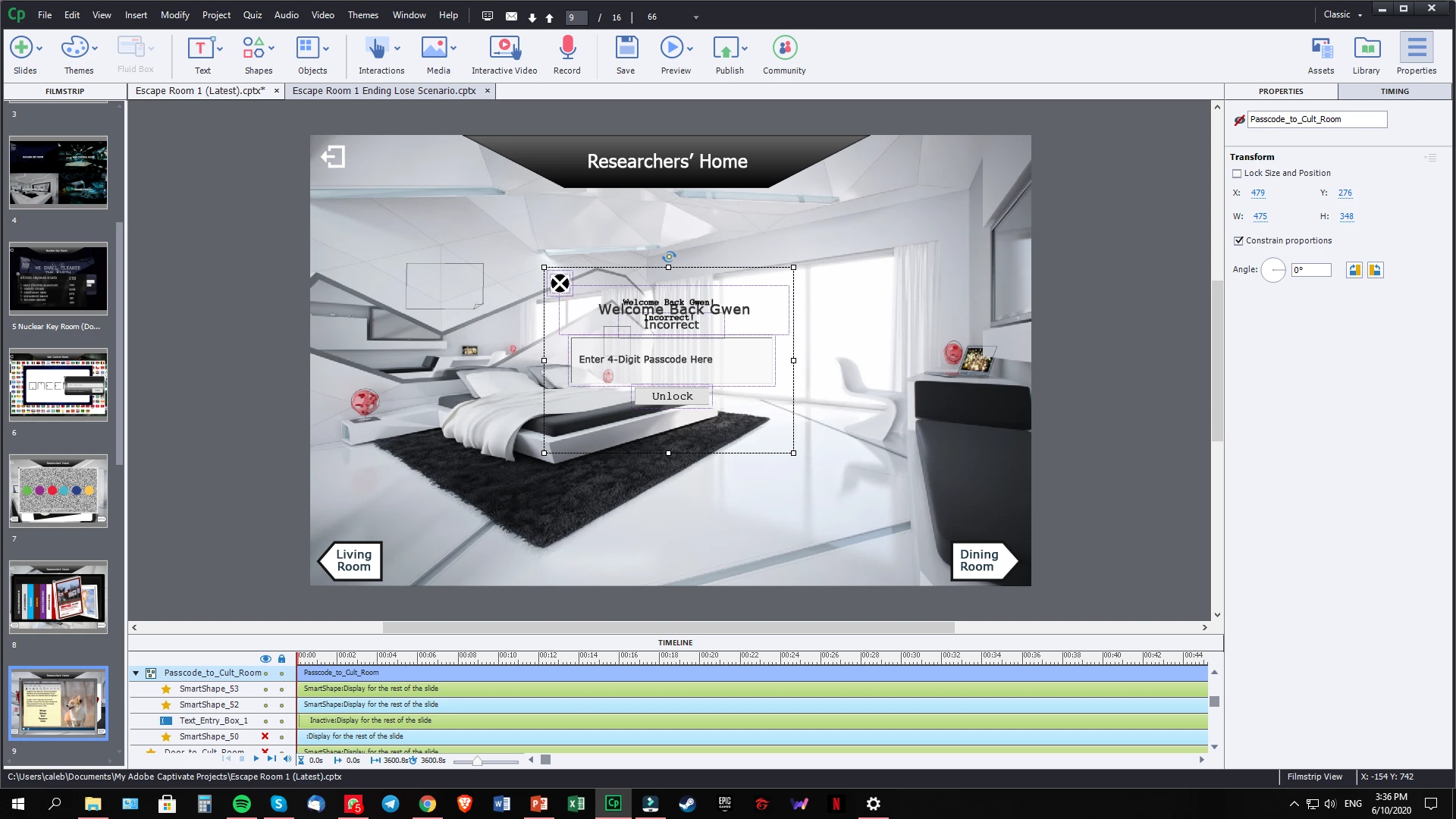

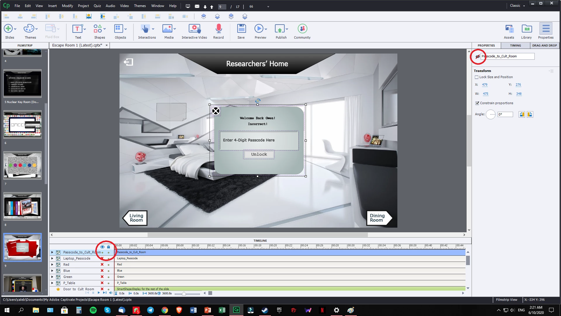

    It could be a bug.  But I would like to see an expanded view of the Passcode to Cult Room group with the specific text object selected that seems to remain unhidden.  Although you have selected the group and set Visible in Output to OFF.  Is that specific item still showing in its Properties setup as Visible in Output?  If it is still set to Visible, then that would explain your issue.
    Oct 6, 2020 7:36 AM UTC
    Hello Rodward!
    Thank you for replying! I have already set it to OFF in output too. And honestly, yeah I feel like it is a bug because it happens for some of the passcodes that I make and some are fine. But I have kept checking that all of the outputs are all turned OFF the same way.
