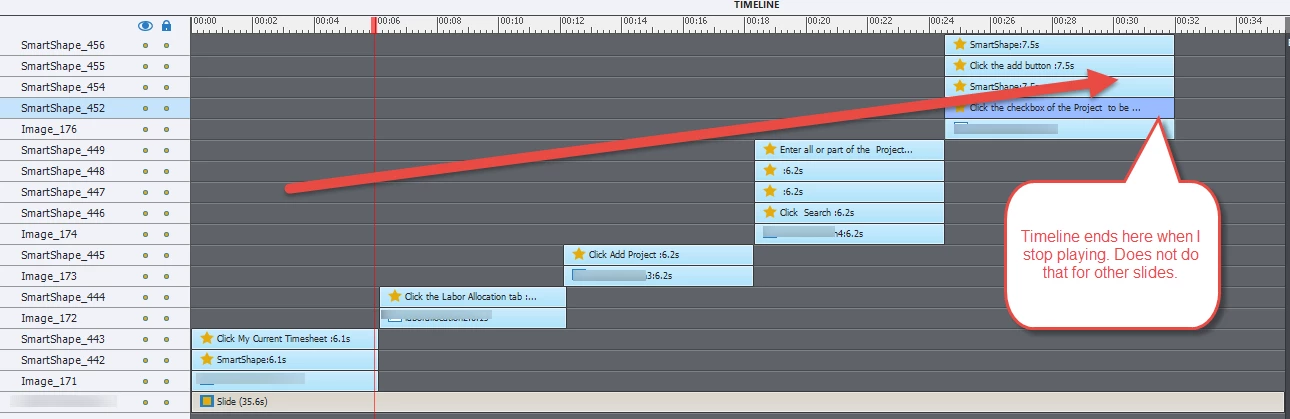

April 20, 2016
This should make the problem more clear.

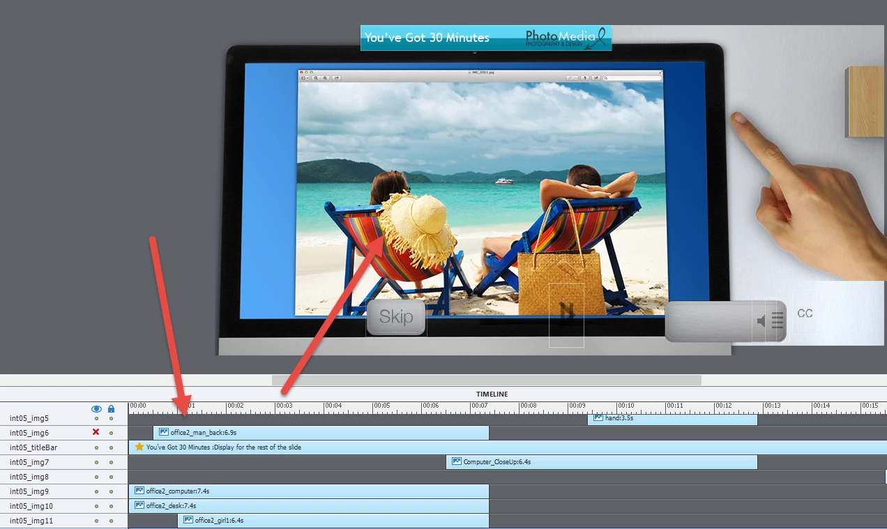

RodWard
April 20, 2016
You seem to be a Flash user who is expecting Captivate to work in a similar way.  It's not and it won't.  So there are some differences that you will need to become familiar with.
Captivate doesn't have onion skins like Flash and the Edit mode doesn't work the same way either.  No matter where your timeline cursor is positioned in Edit mode you will be seeing all objects on the slide that have not been made invisible for editing purposes.  (At least using the small eye icon in the timeline to hide objects in Edit mode works similarly to Flash, but there is also a Visible in Output eye icon in the Properties tab that has control over whether or not the objects are visible at runtime.

There is a problem with one slide and not the others. When I stop the play button it automatically shows the last frame in the timeline. And it doesn't scrub.
