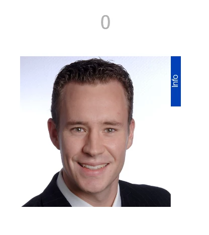

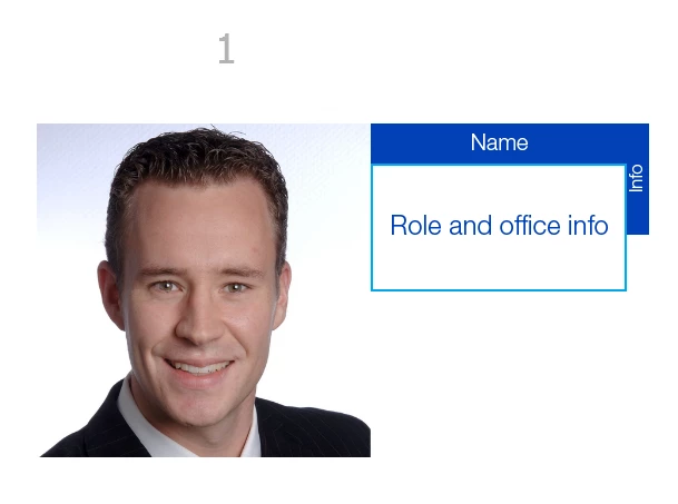

I'm devising a flyout box that's supposed to slide out from behind the picture when you click a button, and then slide back under when you click again. Here's what I've set up:
  • Custom action to slide out left to right
  • Custom action to slide in right to left
  • A group containing four items;
    • two shapes with text (using different colors for the two) that will be hidden behind the picture
    • a third shape with text containing the word "Info" which is sticking out to the right of the picture, connected to the right of the other two boxes
    • A transparent button exactly going over the third shape listed above
  • An advanced action including a variable to match the state of the group (0 if hidden, 1 if shown)
    • If the button is clicked it checks the value of the variable. If 0, the group slides out and changes the variable to 1. Else the group slides in and changes the variable back to 0.
Here's the problem: When I preview, everything works properly. When I preview in browser with HTML5, the group slides out, but it doesn't slide back. The action doesn't fire and the variable doesn't change. The same happens if I publish to HTML5 (which I have to use - SWF is not an option for me).
