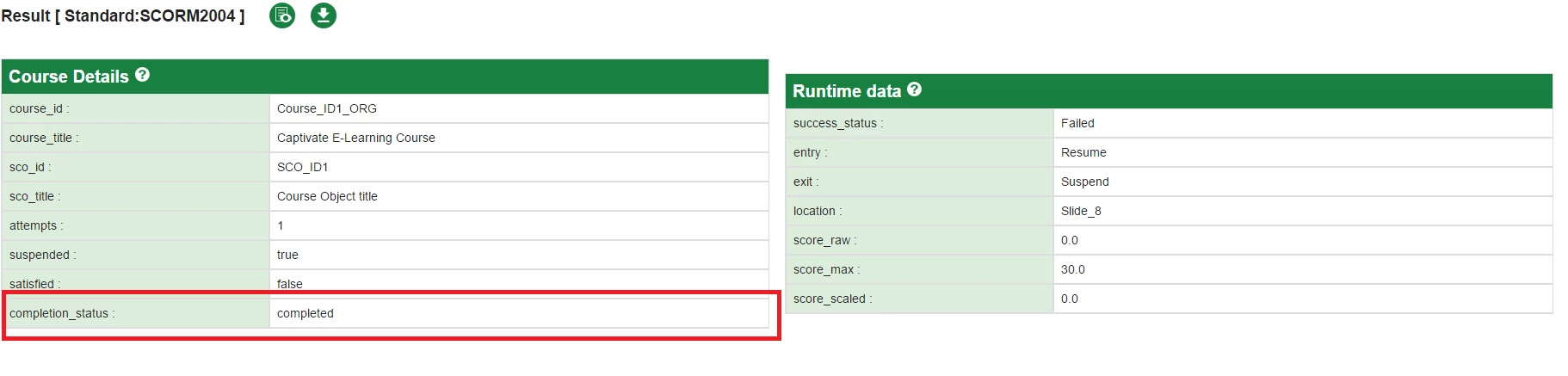

So a user goes through the course to the first knowledge check, attempts that, then exits the course - the user has not attempted the Quiz, only the knowledge check, but the course still registers as complete (and a fail).
I have tried everything I can think of - tested in SCORM Cloud as well as my LMS - even created a new, blank project with nothing in it except a few blank slides, a knowledge check, and a Quiz, and the same problem occurs.

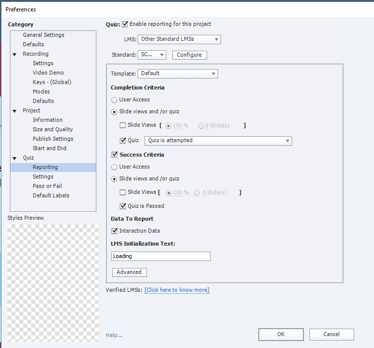

Can you show the settings for Quiz Preferences, Reporting?

Here are the quiz preferences:

Ok, have checked cpQuizInfoAttempts and it behaves as expected - i.e. it remains 0 during and after the knowledge check. But when I exit the project by closing the window (in SCORM Cloud) a 'complete' status is returned.
Very puzzling!
