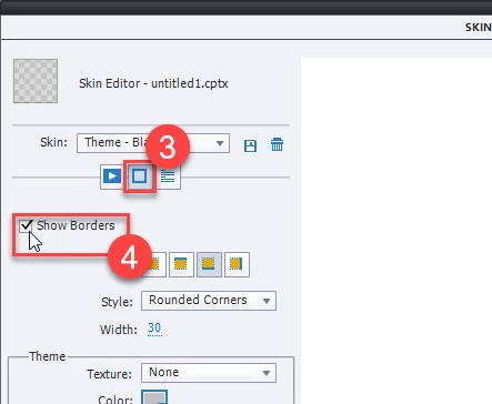

    I'm not sure what you are experiencing but one possibility is that you have borders turned on in your project. You can check this by following these steps...
    1. Click on the Project dropdown menu.
    2. Click on Skin Editor.
    3. Click on the Borders icon.
    4. Uncheck Show Borders if you have any.
