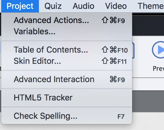

    Have you looked what the unsupported HTML was?  If you got to project>HTML5 tracker. It will give you a list of unsupported stuff. It may just be a text animation, or something insignificant to performance.

    Hi. Thanks.  I tried posting to HTML but I got an error message that said some of my elements were not supported in HTML, so I went with SWF only.

    Not a good idea at all, future of SWF is not very bright! Rollovers are not supported and mentioned in the HMTL5 tracker, but if using a desktop/laptop they will mostly be functional even though they are mentioned not to be. IE is end of life as well, replaced by Edge.
