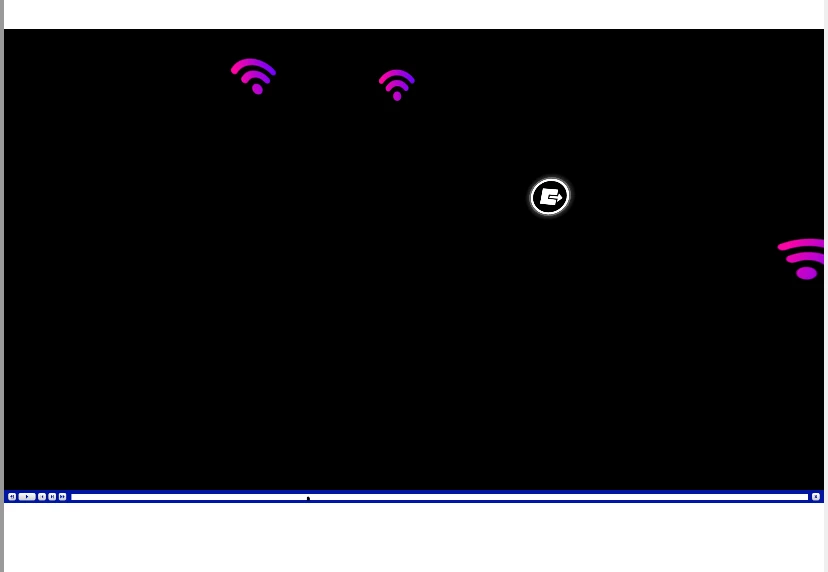

    Jan 25, 2022 3:56 PM UTC
    Hi there @RodWard  im having a similar issue and i havent found any steps to help me fix the issue. I'm hoping you might be able to offer some assistance please?
    i'm in no way an expert in using captivate but have experience in different projects.
    When i preview my project - which contains 360 slides - it previews fine. when published on our LMS it works fine on all devices apart from Apple.
    Are you able to advise - in a step by step manner please - what i need to do to get the 360 slides to work on apple devices (for the learners that only use ipads..)?
    Image of issue attached.
    I have posted on here a few times and so has a colleague but no replies. so i hope you don't mind me tagging you.. You seem very helpful..
