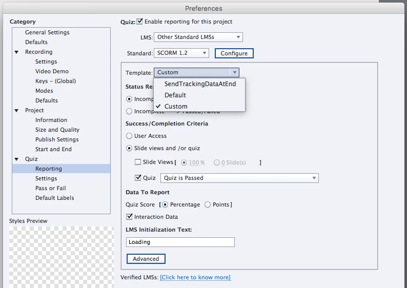

Publish Settings > SCORM 1.2 > Custom Template
I have been searching for any documentation on the Custom Template option available under the SCORM 1.2 option when enabling reporting. Can anyone point me to any resources or help enlighten me as to what this feature is and how to use it?

RodWard
Mar 29, 2019 6:04 PM UTC
You would ONLY use this option if you had access to professional progamming expertise and wanted to create your own customised SCORM template.  That would only be necessary if you had some kind of bespoke LMS that didn't play well with the normal SCORM templates.  If that's not the case, then ignore this option.
chrismay_at_delta6226261
Mar 29, 2019 6:21 PM UTC
Rod,
Can this be used as a way to insert some custom JS, not necessarily having to do with SCORM?
Regardless, do you know where to find more info? I really miss the "manuals" that would detail every window, dialog and panel and all their features along with being nicely indexed...

Lilybiri
Mar 29, 2019 8:18 PM UTC
For JS, why not include an external JS file? Why should it have to be in the SCORM template?
