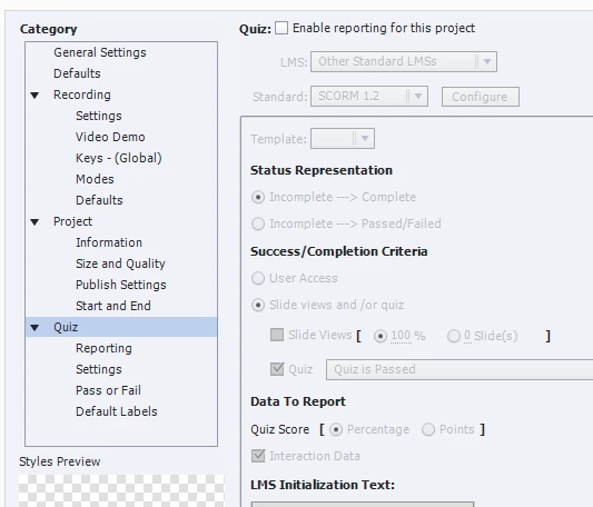

    Check your preferences and make sure that the quiz reporting option is deactivated. I ran into this and that solved it for me. It also allows exit commands and buttons to work properly in fullscreen exe publishing.
