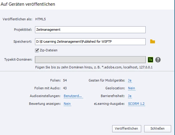

1) When im publishing my project I want it to work on Moodle as a html5 version. Right now Moodle only uses the Flash version when I add it to Moodle as a "Learning Package" and add the ZIP file. After publishing my responsive project the ZIP still contains the .swf, .pdf, and multiscreen.html file as discussed here:Publishing with Captivate 2017 in both Flash and HTML5 at the same time .
The first thing I don't understand is why the ZIP still contains these swf+pdf files since my publishing options only allow for hmtl5 and dont even give me any options. I can't find anything on the Adobe Tutorials here. When I upload it to Moodle, it always starts up with the flash file and I don't find a way to tell Moodle which file to open up. When I delete the .swf and the .pdf file it wont start up anymore. As a different option I can implement it into Moodle as a File/URL but then the LMS doesn't work anymore.

Jan 16, 2019 11:10 AM UTC
Can yoyu show the Putlish settings? Since you still see the multiscreen.html file, I suspect you are publishing both to SWF and to HTML. That is not working very well at this moment.
