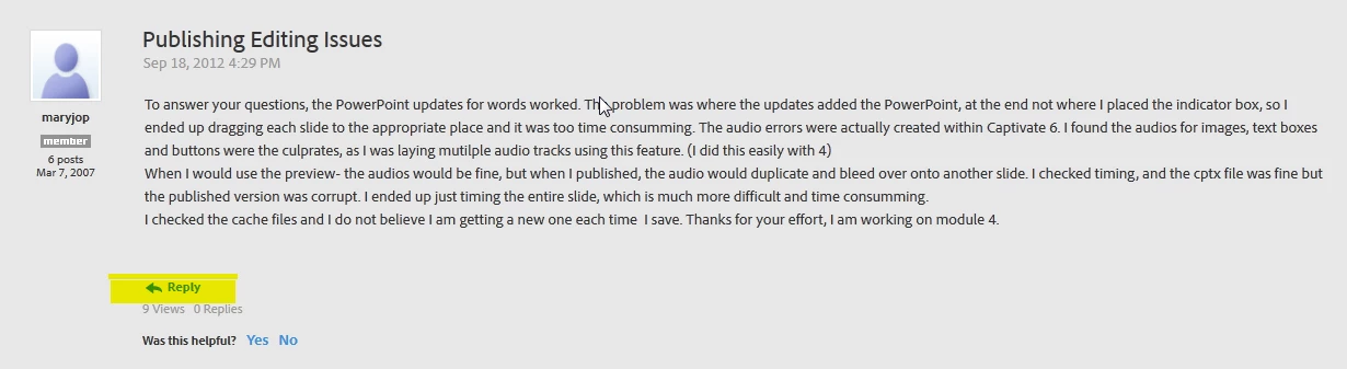

To answer your questions, the PowerPoint updates for words worked. The problem was where the updates added the PowerPoint, at the end not where I placed the indicator box, so I ended up dragging each slide to the appropriate place and it was too time consumming. The audio errors were actually created within Captivate 6. I found the audios for images, text boxes and buttons were the culprates, as I was laying mutilple audio tracks using this feature. (I did this easily with 4)
When I would use the preview- the audios would be fine, but when I published, the audio would duplicate and bleed over onto another slide. I checked timing, and the cptx file was fine but the published version was corrupt. I ended up just timing the entire slide, which is much more difficult and time consumming.
I checked the cache files and I do not believe I am getting a new one each time  I save. Thanks for your effort, I am working on module 4.

    Hi !
    Firstly, I would request, please use the "Reply" (screenshot below) button at the buttom to reply to any user's post on the same thread, so to keep it a single conversation thread, else this way the scattered conversation would confuse users to offer suggestion.
