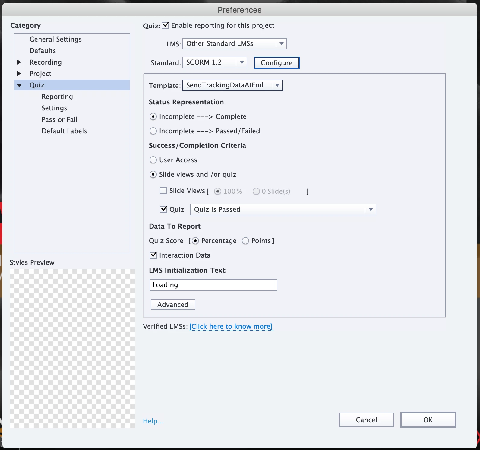

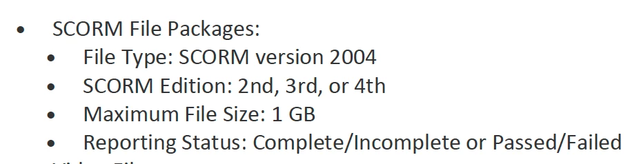

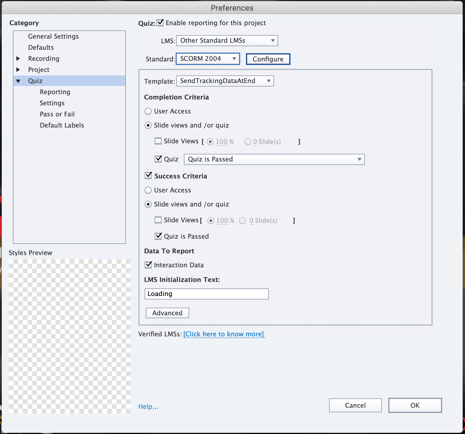

Good afternoon! I am using Captivate 2019 trying to publish my course for SCORM 2004. My LMS is requiring SCORM 2004 with Status Representation - Incomplete - Passed/Failed. However this is not an option when I have SCORM 2004 selected. With out this option the LMS will not be able to keep track of actual scores. This option is available for SCORM 1.2 but NOT 2004. At the end of the course it displays the score but does not send final numbers to the LMS. They are telling me its because I dont have status representation - Incomplete - Passed/Failed checked. I appreciate any input you can give. I have attached the screen shot of what my options are for SCORM 2004. And if you have any input of what my setting should be for SCORM 2004 that would be helpful. I dont really know what the stardards are.

    Complete/Incomplete in your LMS requirements is controlled with the Completion Criteria.
    Passed/Failed is controlled with Success Criteria.
    As soon as you launch the lesson, the completion status should be set to incomplete.
    The completion status can only be one of the following:
    • completed
    • incomplete
    • not attempted
    • unknown
    The success status can only be one of the following:
    • passed
    • failed
    • unknown
    You need to select the default template instead of the SendTrackingDataAtEnd.
    So you can set completion criteria as 100% of slides viewed and leave the Success Criteria as you have it. The LMS should then show Complete and either Passed or Failed.
    You can also set it up with quiz attempts and not let the user reach the last slide unless they pass the quiz so it would show:
    Incomplete and Failed or Complete and Passed.

    Status Representation is merely how your learner's attempt at your eLearning is represented in the LMS. It can only be communicated as one of the following.
    • Incomplete
    • Complete
    • Passed
    • Failed
    In SCORM 1.2 this representation is determined by either user access, slide views and/or quiz results. In SCORM 2004 these characteristics were separated so that learners could be considered complete and successful for different or possibly the same determining factors. If your LMS is asking for status representation than it is likely looking for SCORM 1.2 as it doesn't really exist in 2004. Perhaps check with your LMS provider and double-check if they are in fact looking for 1.2 or 2004.

    RodWard
    May 27, 2020 12:50 AM UTC
    As Paul correctly said, SCORM 1.2 only had one variable to try and communicate to the LMS what are essentially two different things, i.e  Completion (whether or not the learner reached a point where they could be considered to have completed the module) and Success (whether or not the learner had passed the module).
    This was later recognised to be a severe limitation and so when SCORM 2004 was released the completion and success criteria were split out to be handled by two different SCORM variables so that educators could more accurately report completion and success.
    You can find more information about the differences between these two SCORM versions here:
    https://scorm.com/scorm-explained/business-of-scorm/scorm-versions/
    https://myelearningworld.com/scorm-12-vs-scorm-2004/
