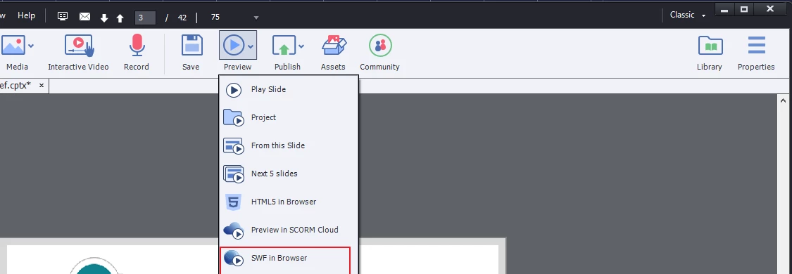

    I am trying to resolve the issues with #2 - While recording, all the content was within the "Red Recording Window" correctly with the resolution and stuff which I am trying to adhere to. When I preview and check the entire project, I have NO issues with ANY of these options like the SWF highlighted except the HTML5 (image below). With html5 in Browser, "some" of the screens are getting cropped/cut off at the edges but for the other preview options, I have neither Issues 1 or 2!!
    • Can the issues in #2 (cropping of image/window) be resolved WITHOUT me having to redo the entire recording again? Any settings to apply (or workarounds to perform) to the existing content that will help?
