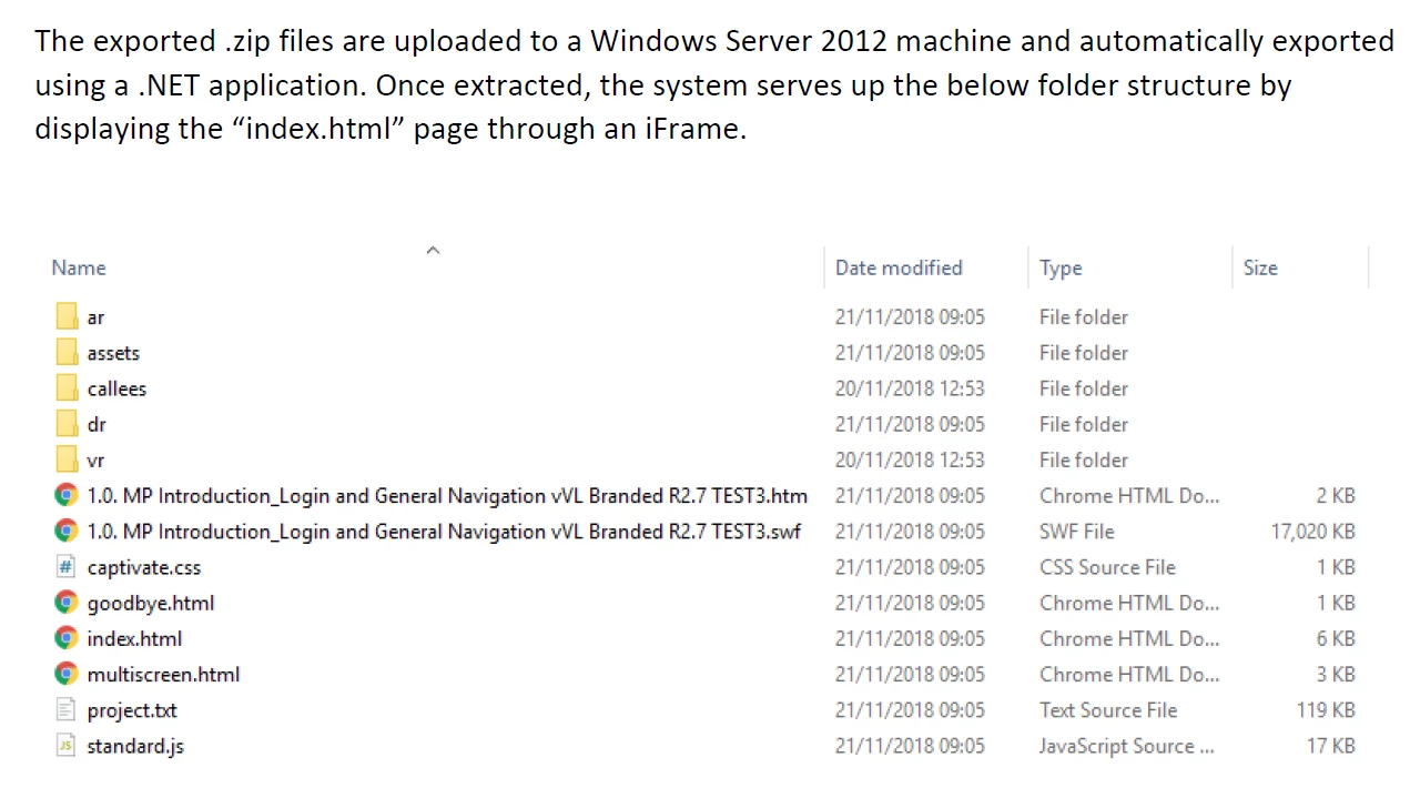

Our platform receives the full .zip
file HTML5-based export from Captivate and extracts it to a folder location
that is tied to a specific training item in the portal. When a user requests
that training item, we serve up an iFrame that points to the “index.html” file
within the extracted folder, and from there the full experience (play/pause,
controls, content) is handled by the Captivate export itself.
This is all deployed onto Windows
Server 2012, configured for .NET application deployments. We have tried Adobe
Flash exports in the past, but browser inconsistencies meant that the HTML5
export was the preferred mechanism. We have also previously researched the
SCORM requirements as the third possible export option, but licencing
requirements on the server again left HTML5 as the preference.

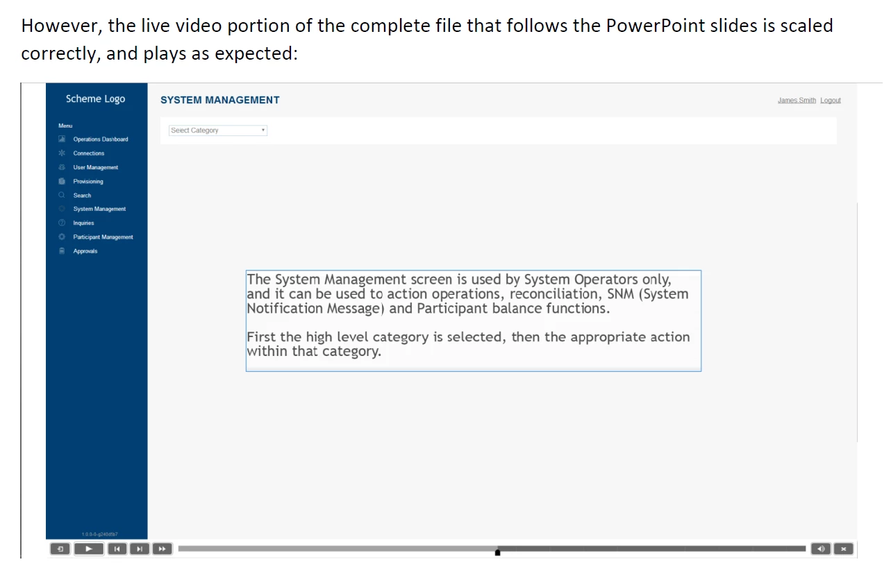

The server is configured for JSON filetypes. We have previously used Captivate HTML5 exports on this server and they continue to work correctly, and the current files that we're having an issue with work fine for the video/screen-capture aspects.

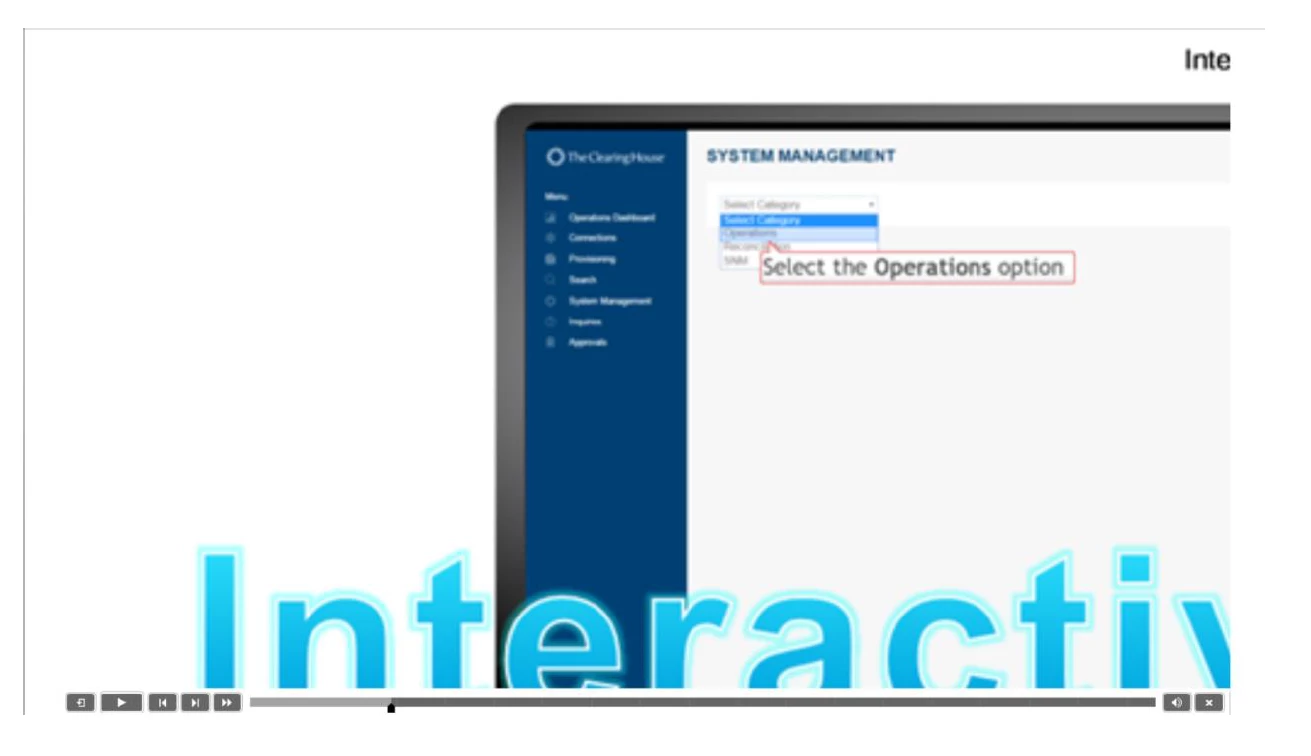

Agreed. I've not seen this before and I would suspect something with the PPT deck. For example, if you edit an image in Photoshop that has perfectly reasonable screen dimensions (i.e. 800x600) but is at 300 DPI (as opposed to 72 or 90), the image is going to render HUGE on a web browser due to that DPI.
I'm not sure if there's something similar in PPT but maybe.
How about making a copy of the project, remove the PPT emeds, and replace with two example screens where you simply copy/paste two slides of content from PPT into those CP slides, publish, and test.
Still huge? Likely something with the PPT content itself.
Not huge? Something funky with the PPT settings (like, maybe it was designed at a Large size but is being viewed at a scaled-down 50% in PPT itself so it's not noticable?
I think you can save PPT as HTML, no? Right from PPT Save-As...? If so, maybe try that and load from a generic webserver and see if the same issues persist?

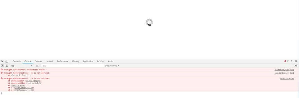

Eric is correct. My bad.  There is no SCORM imsmanifest.xml file involved in this particular case.  However, what I said above about the multiscreen.html file probably redirecting to the wrong output is still likely, unless you are launching the output directly from the index.html file, which then does launch the HTML5 output, not SWF.
All Captivate versions since late Cp 9 now use JSON files in the HTML5 output to deliver PNG or GIF images.  So if your web server is not set up to allow JSON files, that can prevent the output from playing and cause the endless loading issue.  (The loading GIF itself is not delivered by JSON.)
Your setup is somewhat unusual, involving multiple systems.  So, to first work out whether or not the root cause of this issue is external to the course module, I would suggest you find another web server where you can upload your content and test from there to see if it still misbehaves the same way (with enlarged PPT images etc).  That web server would also need to have JSON files enabled.

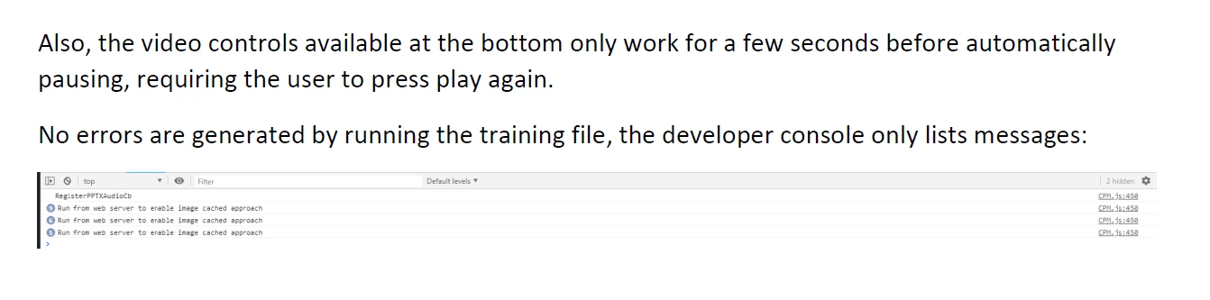

Thanks for your responses. I will forward them to the person who manages the host platform. We tested the separately published files and we are still experiencing the same publishing issues.
The PP element is directly imported into Captivate. It plays fine when previewed in Captivate 9.0. Would the version of Captivate used for publishing have an impact? We think it was Captivate 10 used to publish the files that were previously published and work fine on the platform, but Captivate 9 used to publish the recent files that are experiencing this error.

Response from Host Platform Manager following recent test:
The SWF one is the same result as this morning. The HTML5 one is as we’ve been experiencing previously – the
player displays and loads content, but the scaling of the PowerPoint portion is
the same, and the player automatically stops after a few seconds of play. It
would be worth checking with Adobe as to whether there were changes between
versions 9 and 10 around this area of the product? They may have release notes
available that could highlight changes to the exporting logic.

Your screenshots indicate that you are still publishing to both SWF as well as HTML5.  In that instance the SCORM manifest file will first point to the multiscreen.html file which is a 'sniffer' file intended to detect which of the two outputs should be delivered to the end user.  Although you may be wanting HTML5 to be that output, for desktop systems the sniffer will think they should get SWF.
So I suggest that you STOP publishing to dual output and just select HTML5 only as the output.  Then your SCORM manifest will point to the index.html file for the HTML5 output only.
