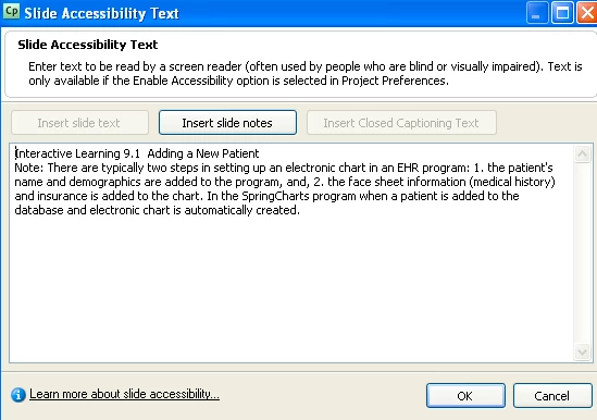

I will need to add Accessibility and close captioning support. I have checked this off in the Project settings and migrated to slide one properties.
Click on Accessibility and the panel defaults to three tabs. The directions I am seeing suggest text in this field will be read by an appropriate screen reader. However why is close caption and slide text buttons grey?
Using CP 4.01 with the latest update 1658
Correct answer Captiv8r
Hi there
Closed Captioning will only be available if you have audio on the slide. Do you have audio?
Cheers... Rick

Hi there
Cheers... Rick

I think that is the clue. My production process is getting the text in and the layouts finalized first then back in audio files as I might have to chop up the segments differently than planned.
Thanks
