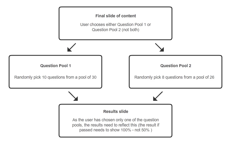

I've tried to work out a solution to a question pool problem but not having much joy. I've attempted to describe the problem but thought a diagram would be easier to explain. Does anyone know if the attached image is possible in Adobe Captivate 8 please?

    You may be able to do this by using Branch Aware.  Only the quiz questions that the learner actually visits will be taken into account in the quiz.

    You can see some tips and a use case in this blog post:
    Branch Aware Quiz - Captivate blog
    You'll read also about the navigation limitation when using Branch aware.
