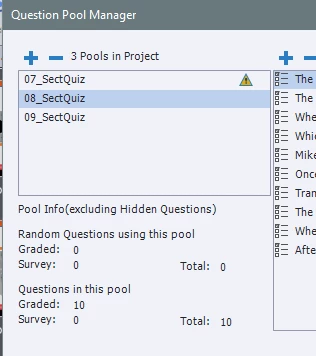

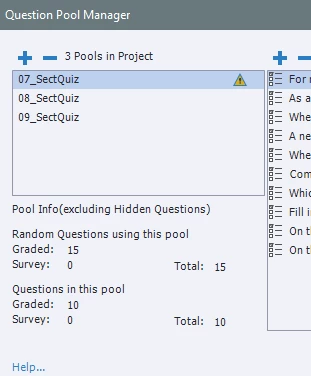

Regardless of what I try, the first pool on the list in the question pool manager has an error shield and 15 "Random Questions using this pool" associated with it. Note the differences between the information provided for 07_SectQuiz and 08_SectQuiz in these two screenshots:

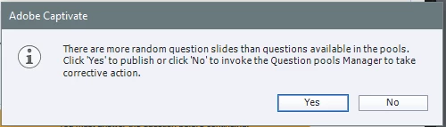

As a result of this, upon publishing I receive the following message:
  • If I click "Yes" and publish, the program works just fine until it reaches then end of the questions associated with 07, then the published program just freezes.
  • If I click "No" and "invoke the Question pools Manager" (sic), there do not appear to be any "corrective actions" I can take.
I tried reloading the original 07 GIFT file into a new pool and then deleting the offending 07_SectQuiz pool. No love. Instead, immediately, 08_SectQuiz moved into the error position.

    Each of your Random Question Slides must be associated with a specific Question Pool.
    Your screen shots seem to show that two of the Question Pools have no associated Random Question slides.
    Check each Random Question Slide and make sure only 5 are associated with each pool.

    Hi Rod, I have the exact same problem, but I don't understand HOW I can check each Random Question Slide to make sure that only a certain number is associated with the respective pool. Is there a way to do this in the question pool manager? I went to insert question slide, clicked on random question at the bottom and chose the correct pool. I did that three times now and the random questions add up everytime I do it. I now have 26 random question in a question pool of 15...

    Open the panel 'Question Pool' to see the questions in the pool (from Window menu). I create a workspace in the Expert UI where the question pool is added to the bottom docking station. That same docking station has also the Timeline, but for a question slide the Timeline is not showing a lot of information since all objects are embedded except eventually added custom objects.
    When you insert a Random slide, the grey placeholder clearly mentions which pool will be used for this random slide. It would be nice to have that information also in the Advanced Interaction panel, but that is not the case.

    Hi Lilybiri, you are my Captivate hero and keeper of my sanity! Thank you, I've found the panel (hallelujah) and deleted all the superflous questions by deleting the grey placeholders....
