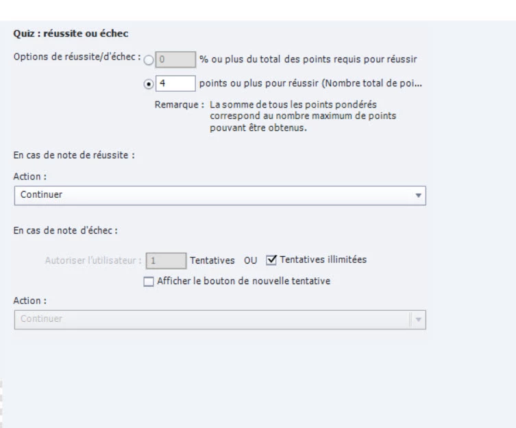

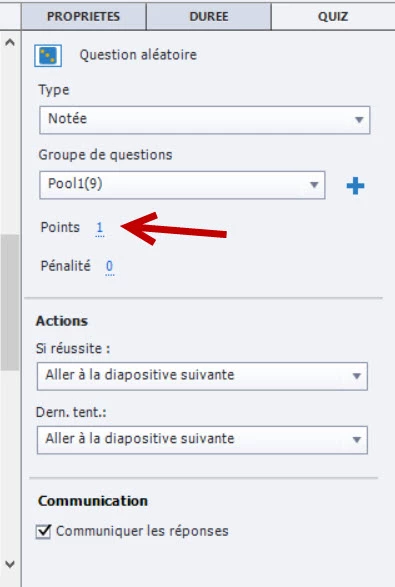

I have a module with a question pool. I have 5 random question page (9 questions in my pool). Each random page is 1 pt.
My passing score is 4 pt
Once in the LMS, if I have at least 4 good question, the information send is "Completed".
If I have less than 4, the module is always marked as "incomplete" instead of Failed.
How can I have the Failed status?
See my captuer for my setting.

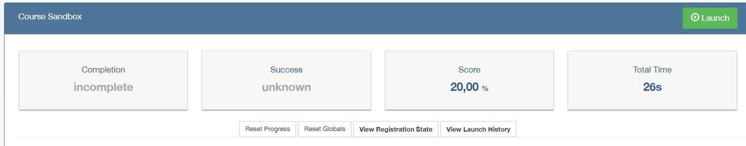

    In scorm cloud, I have try with 4 pt as passing score and I have try with 80% as passing score and in both situation, the status is always Incomplete. See this capture.

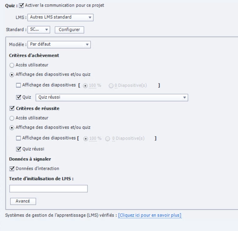

    You are using exactly the same criterion for 'achèvement' et 'réussite', which means you could have done it with SCORM 1.2 instead of 2004. Why not use a different criterion? Keep the 'réussite' settings, but change the 'achèvement' to something based on slide views, or change the Quiz requirement from réussite to 'attempted' (I don't know the French term for that). I don't understand why the priority has changed here in case of failure.
