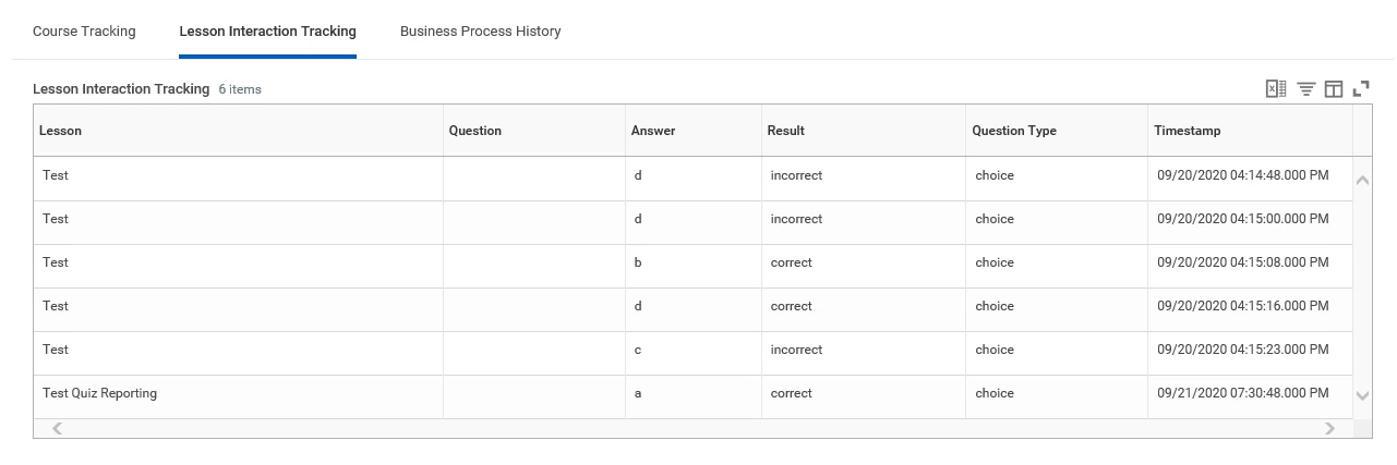

We use Workday as our LMS and Captivate for our projects. Workday saved the question answer, question type, score, and date and time. However, it is not saving the question. I have enabled reporting for my quiz project. I set all the settings applicable for the quiz under Status Representation, Success/Completion Criteria, Data to Report and Advanced. Under Advanced I did check Send Data On Every Slide. Does anyone know what would cause this issue?

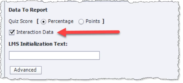

    Is Interaction Data checkbos selected?

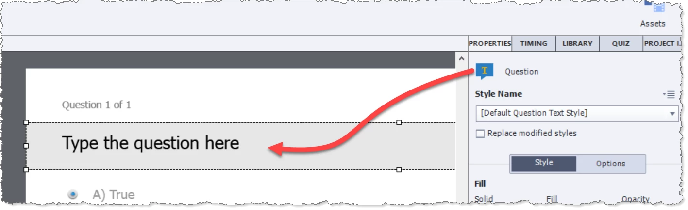

    If yes, have you perhaps been messing with the default captions in the quiz question slides and somehow managed to remove or replace the default Question Text captions?
    These are not normal text captions but special object types that only occur on quiz questions.  If you accidentally delete them, just replacing them with another caption won't do.  You'll need to replace the quiz slide.

    Thank you so much! I have double checked that and I even created a new test project. I made sure that all quiz reporting settings were enabled and I made sure that I didn't change the question type. It is still not recording the question in the WD LMS (see example below).  Do you have any other suggestions on what I can check?

    I would still blame your LMS.  Try uploading the same SCORM to SCORM Cloud and test it there.
