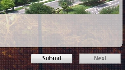

I have a simple multiple choice quiz in Captivate 6 and it works just fine. The only problem is that the Next button is grayed out, even though it is functional. I don't want the student to be mislead and think that s/he is not ready to advance to the next slide yet.
Does someone have an idea of what is causing that? Thank you in advance!

Correct answer SIM_ONE
I have not actually seen this issue before personally.
But try changing Required setting to Optional and then look to see if the button is no longer greyed out when you publish.
If the button is still faded, check if there are any effects applied to the button.

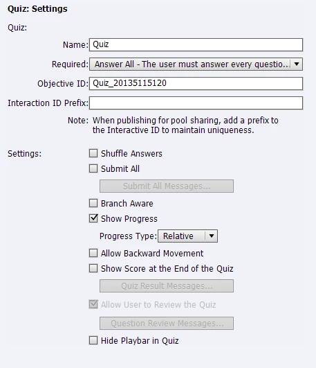

You were right all the time, the quiz settings were causing the "issue". I should have used "Required", instead of "Answer All".
Case closed.

What is your setting under Quiz > Quiz Preferences > Settings > Required?
SIM_ONEAuthor
July 1, 2013
Hi RodWard
I don't have that exact sequence of commands but I have this screen under File > Preferences:
Thank you for your help.
Simone
