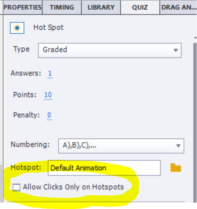

Personally I never have liked the default hotspot question, and you bumped only on one of the reasons. Your next button will be interpreted as a wrong hotspot. Did you limit clicking functionality to the hotspots themselves?

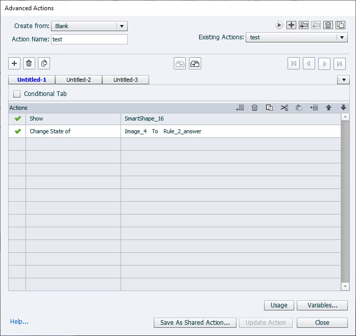

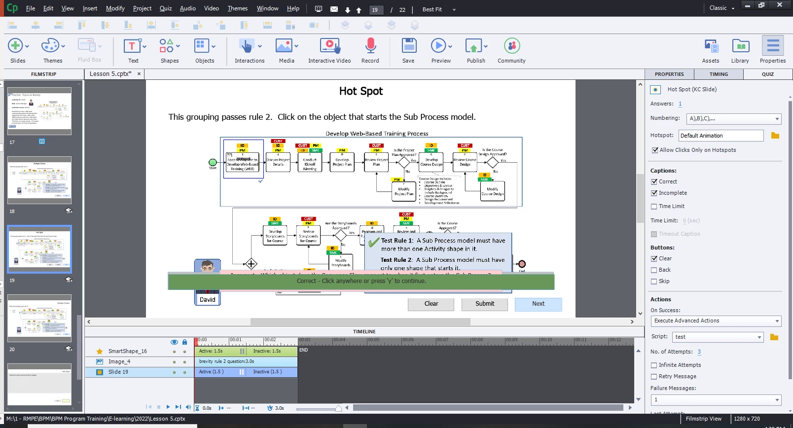

Just saw that check box and still no response.  Here are screen shots of the question and the Advanced actions box:
But having played around with it more, you are correct - the hotspot slide sees everything as a possible answer.  The Submit and Clear buttons are excluded probably because of some programming.  Is there a way to work around that?

Indeed, the embedded buttons (they do not have an individual timeline) have a lot of functionality built in and will not be seen as part of the hotspot canvas.
I told you the workaround: create a custom question, where you use a shape button as hotspot. You make it invisible by setting Fill Alpha and stroke to 0. It can be scored and added to the Quiz Total. Now you have full control over the Success and Last Attempt actions for the shape button. It will be reset if you use the Retake button on the Results slide. The only loss you'll have is the Review functionality where the correct answer and given answer is shown.
You do the state change only on Success? You have a Success caption, which means you have the two-step Submit process. You can increase the time after the pausing point by increasing the duration of the slide, Continue would then allow more time to look at the image.
