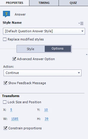

    You were both correct, I was looking for intrinsic feedback on multiple choice questions. I wanted customized feedback on the correct option, and on the other values to help the quiz participant. I was struggling yesterday (I have no formal training on Captivate)  to not only to select the correct answer, but add the customized feedback.

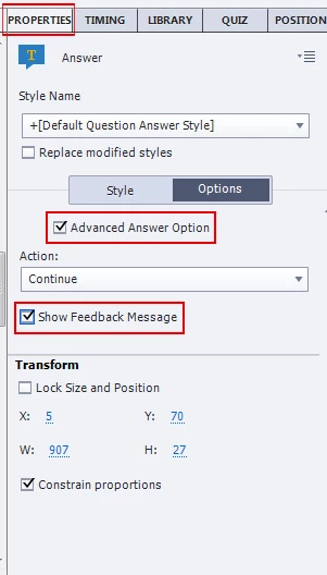

    TLCMediaDesign, when selecting a quiz properties, I have different properties/options then yourself. How do I add the additional options?

    I don't have CP9 at this moment, but click on the Options tab that is the screen shot you supplied. Then when you click on each of the responses you should get the options for the feedback.

    I think you are talking about intrinsic feedback?
    Click on one of the responses in the quiz, make sure you have a properties/options tab on the right. Then select the options shown in the image. Additional feedback captions will then be added to the stage.
