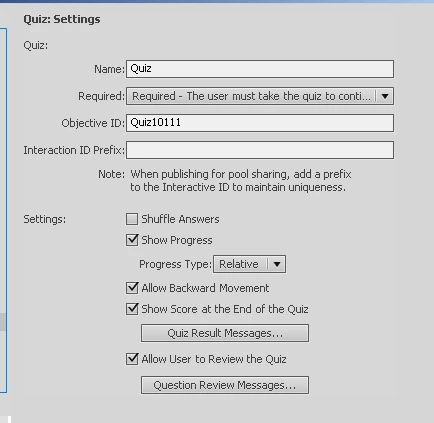

Anyone else experienced this or have a clue how to fix it? My preferences are as follows:

What was the setting for 'Required'?
