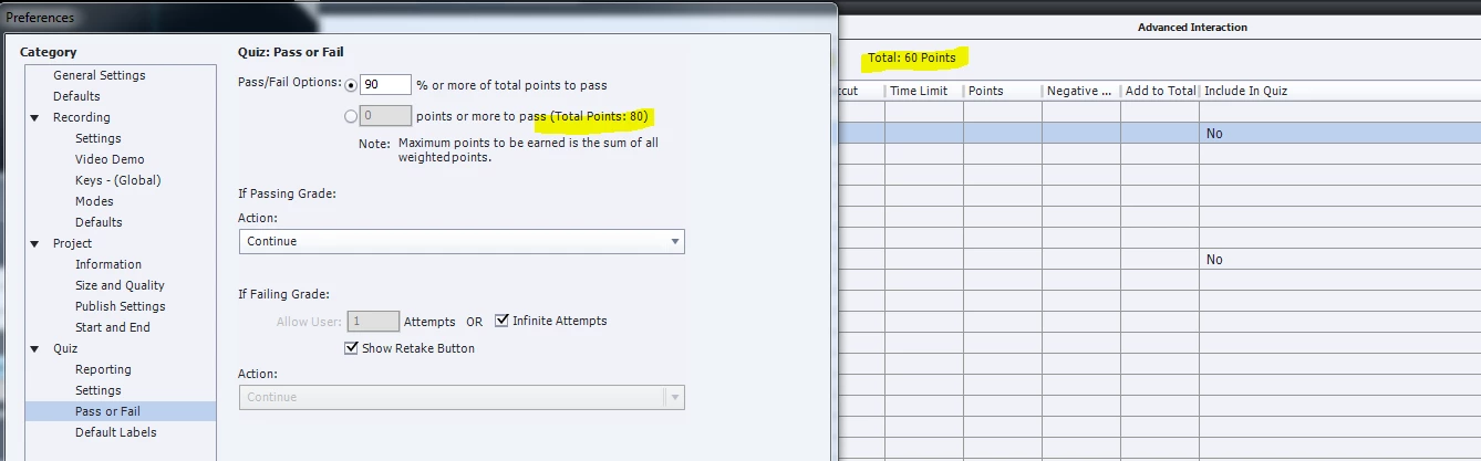

Has anyone come across a discrepancy like this? Initially it threw me off, but when I tested my quiz it was fine (only 6 questions are being scored). The Advanced Interaction tab shows exactly six slides worth 10 points each, but the preferences is showing a total of 80 points. Is this a known issue or just a glitch in my file? The project scores this fine when I run it locally, but my concern is will it report correctly to the LMS?

Put it into SCORM Cloud and try it.
This points field can be a bit confusing. What you're seeing in the Quiz PassFail dialog is showing the total number of points that could possibly be reported to the quiz.  It's not exactly the same as the total number of points from objects that ARE currently set to report to the quiz.  And the number of points shown in the Project > Advanced Interaction dialog doesn't always match this number.  As I said, it's confusing.

Hi RodWard,
Thanks for the insight. I tested it out on SCORM Cloud and the quiz registered 60 points! What you said about this discrepancy is correct.
