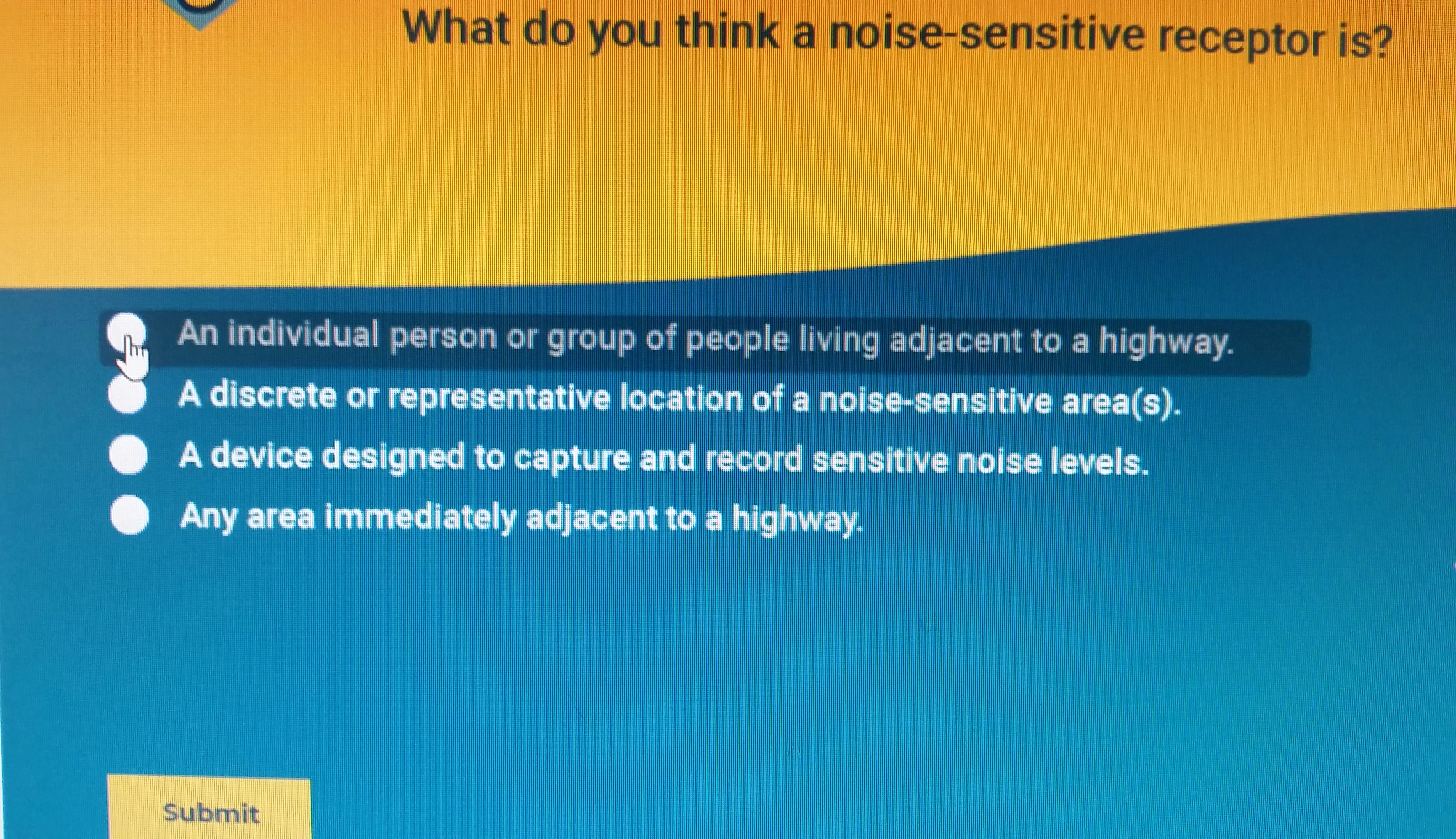

    Mar 30, 2021 4:23 PM UTC
    Thank you for your prompt reply! I checked about the default objects (I'd read that in one of your other posts) and rebuilt the slides but that didn't solve the problem. I've also tried different browsers and different computers. It acts as though there is a giant click box around the entire screen that has to be clicked first before the question can be answered. In some instances, this also results in an auto-advance to the next slide. This seems to happen randomly so I can't get a consistent result. I can tell it won't work when the cursor is a hand regardless of where it is on the screen, including over non-clickable objects. I can't do a screen grab that includes the cursor so here's a photo of what happens on the first click - the answer is not registered. You then have to click again to answer the question. Is there anything in particular you want to see?
