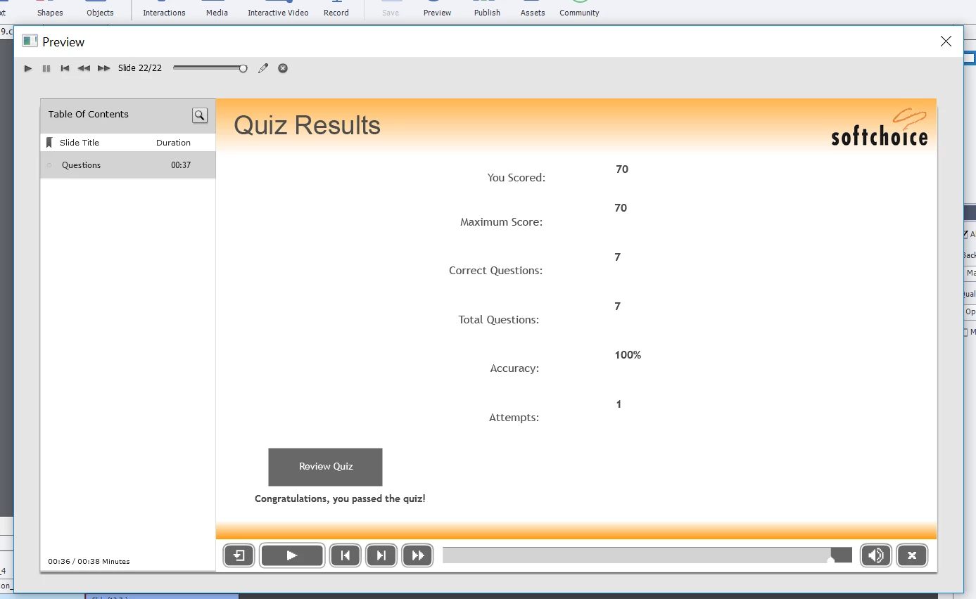

Quiz results slide- Alignment problem
Hello!
I am having an issue with my quiz results slide alignment. As you can see, the right side is much higher then the left side. Does anyone have any suggestions besides creating my own quiz results slide? Thank you!!

    Which version do you use, please? Which theme? Was this theme created originally in this version?
    I suspect this is a non-responsive project, correct?  If the answer is Yes, you are using one of the Preview methods which is based on SWF output. Do you want output to SWF? If you opt for HTML output, the only Preview method to be trusted is F11, Preview HTML in Browser. Did you test it with that Preview?
    Can you check the results master slide, how does it look?

    cassandrar20941960
    Feb 19, 2019 3:32 PM UTC
    Thank you, this was very helpful! Were using Captivate 2019. We were exporting in both flash and HTML 5. Now we have it working in HTML.
    Lilybiri
    Feb 19, 2019 3:57 PM UTC
    The multiscreen option is not working well since HTML output and SWF output became more different. Logical that the team now don't bother ahout SWF output that much anymore.
    Even when Preview HTML in Browser is not working perfectly it is possible that the published output is OK once uploaded to a webserver or a LMS.
