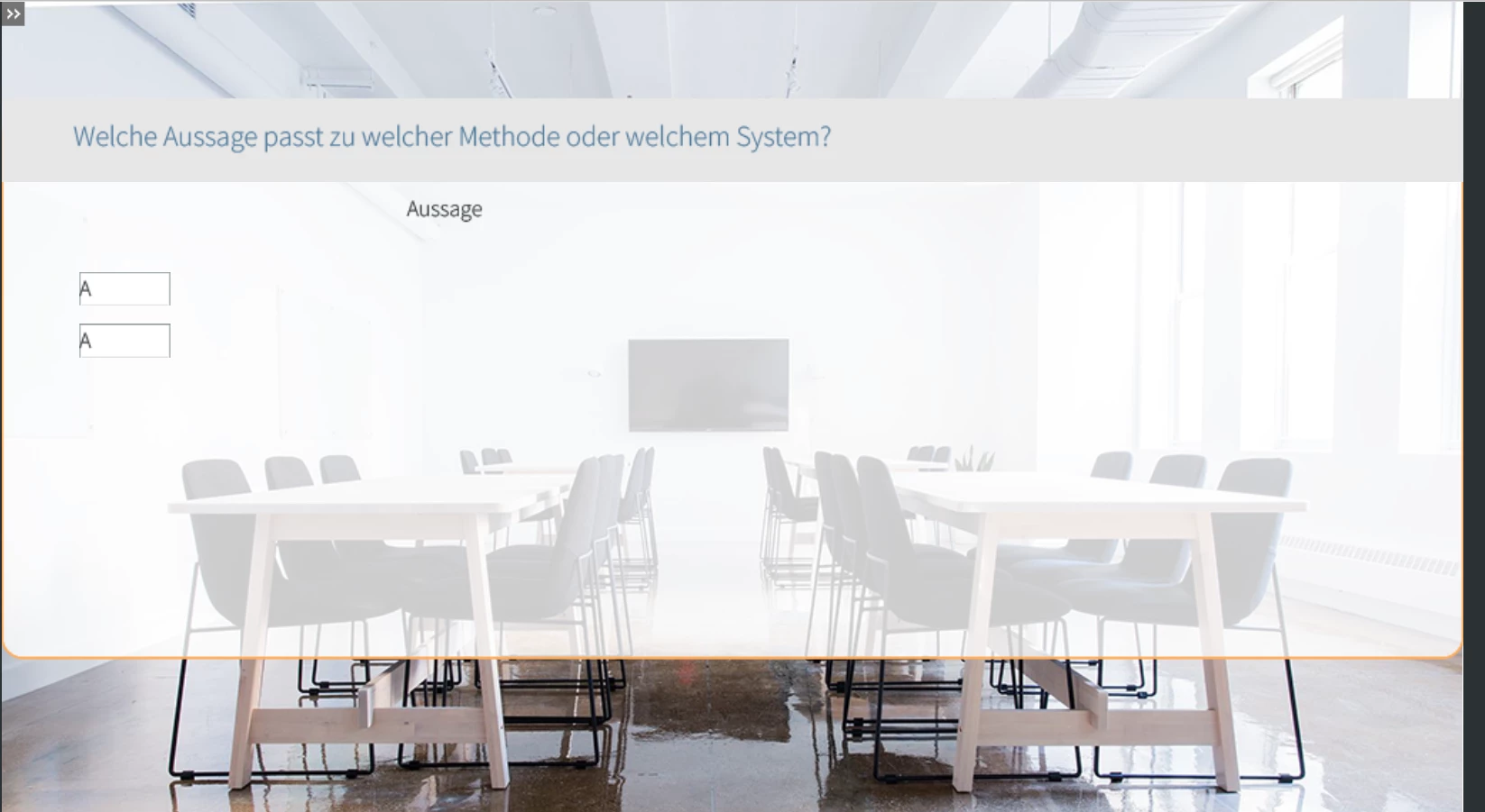

But when I do some changes on other slides and publish the course again, the quiz is loosing elements when playing the course:
But in pre-view inside of captivate everything is fine. Even when I create the slide new - it is working correct. But a second publish without touching the quiz slide will cause that issue.

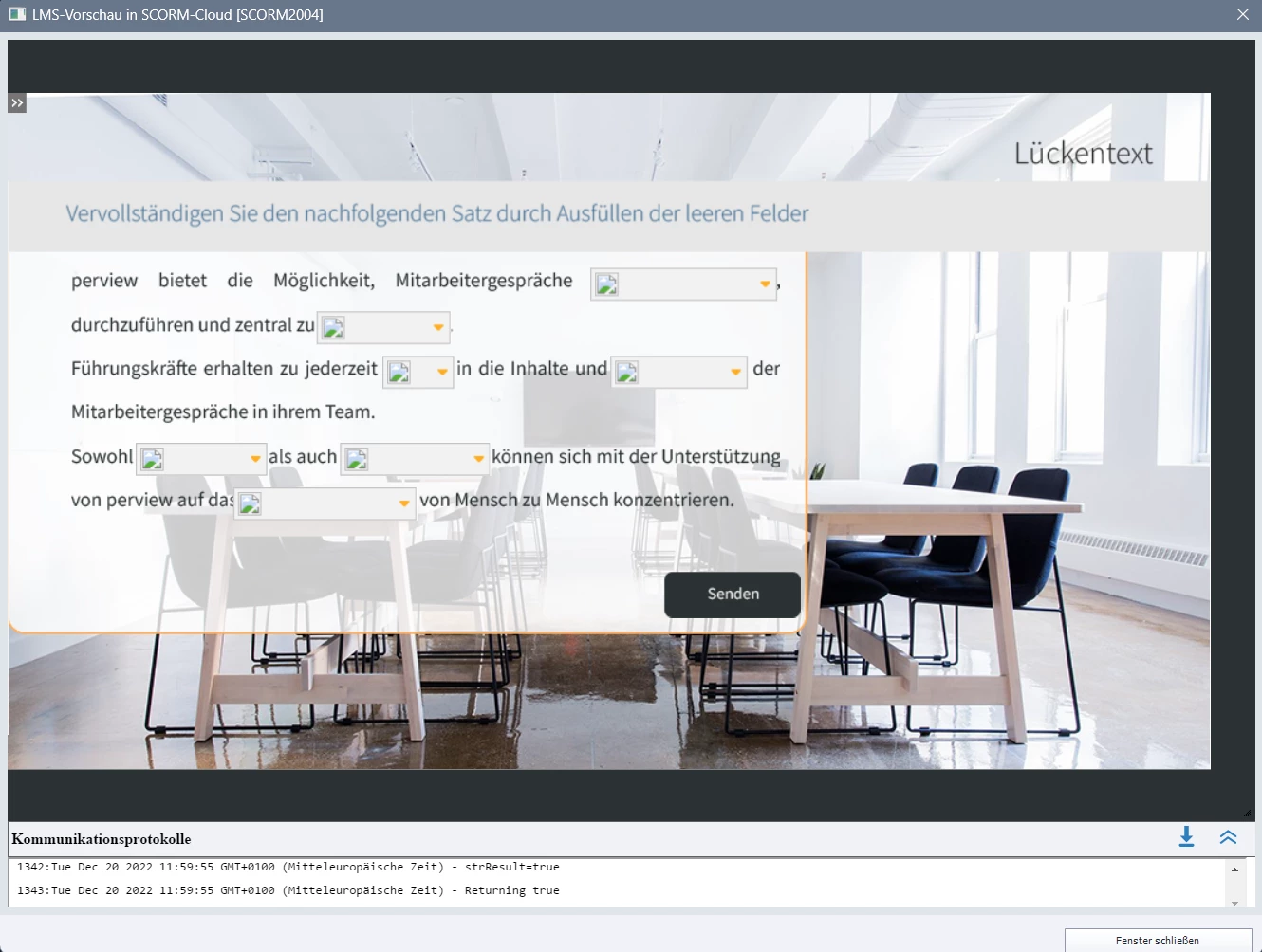

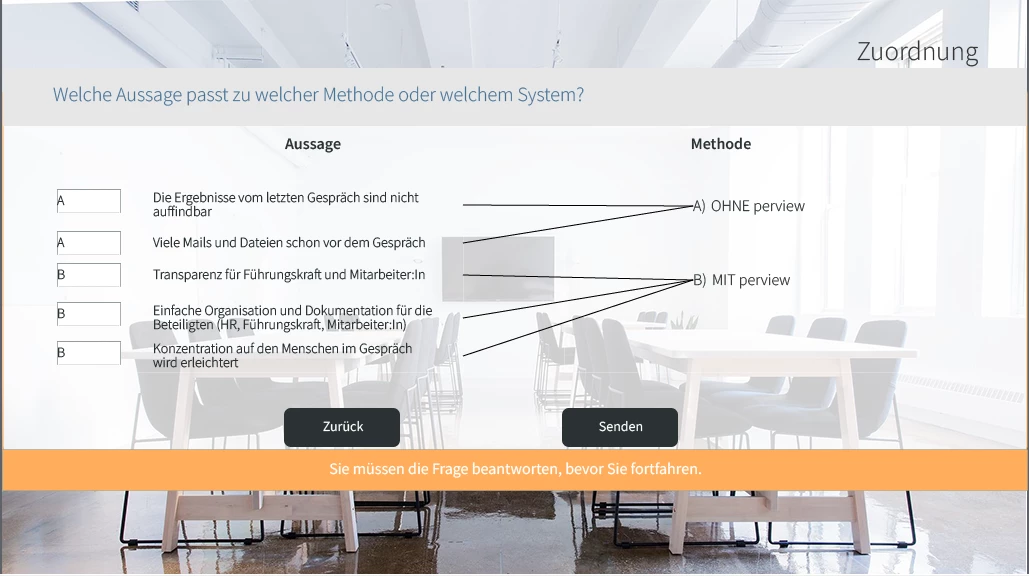

    I adjusted the theme to a customized one. When you might have a look to the screens above. The first one is the setup. But displayed is the second one. So nearby everything is gone.

    thanks for your thoughts. I´ve tested it on Scorm Cloud. It seems to be the same.
    Why is the picture missing? But again, when I create it as a new slide, then it is working in the first publish.
