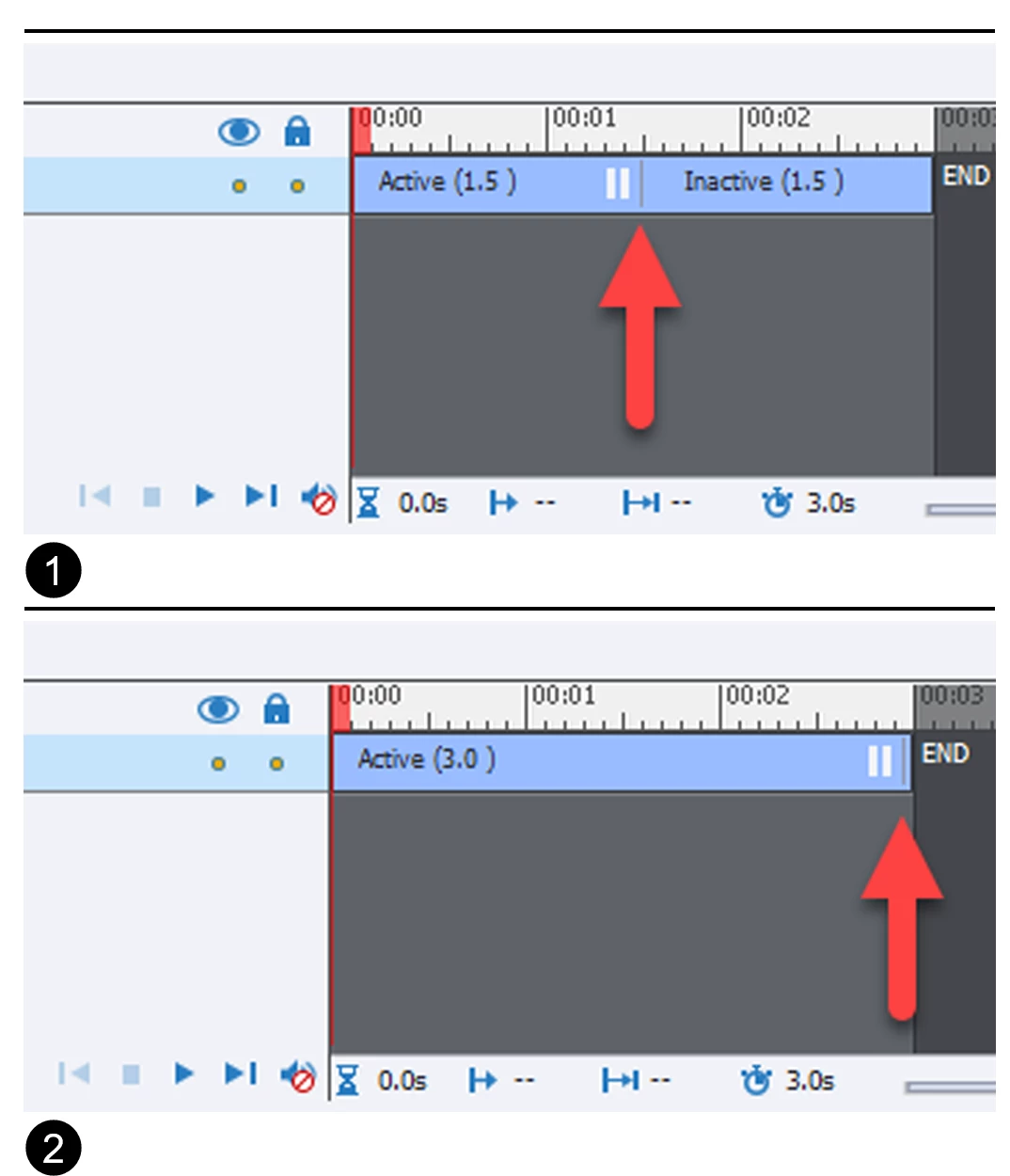

    Changing the On Success action is only half the battle. You should also change the action for Last Attempt as well. You could also try pushing the pause point to later on the slide. Hover your mouse over the pause point of the slide and click and drag it to a later position on the slide. You can keep the action of Continue if the pause point is at the end of the slide like this.

    @susanc56780436 Please, NEVER push the pausing point till the last frame of the quiz slide. I have mentioned the reason in the first answer. Reason is also explained in the quiz blog post.

    Changing the Success/Last Attempt actions from Continue to Go to Next slide is not always a good idea, because it can cause issues after publishing (in case of low bandwidth and transmitting data after each quiz slide).  A better solution is to move the pausing point of the quiz slide closer towards the end of the slide, but not fully at the end. That will reduce the 'inactive' portion of the slide and make the waiting time shorter.
