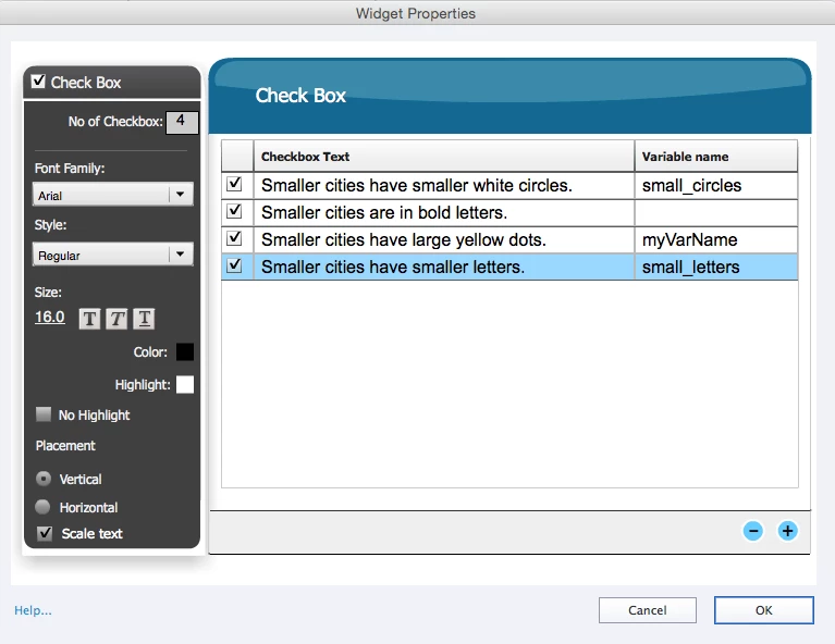

    You have to define a variable for each of the check boxes, will label them (same sequence as in your setup):
      v_circles
      v_bold
      v_yellow
      v_small
    You have to do that in the Project, Variables dialog box. You can leave the default value empty.
    Type in those variables in the second column, exactly same way (they are case sensitive).
    The submit button needs a pausing point, is that the case?
    The conditional action needs to test all variables, not just one. I asked you to post a complete Preview of the action (with the first button i the top right of the dialog box, looks like a play button, a right-pointed arrow). It should look like this
    First decision (first Untitled):
       IF v_circles is equal to 'Smaller cites have smaller white circles'
          Hide Gr_texts
          Show Tx_WhiteCircles
    Second decision
       IF v_bold is equal to 'Smaller cities are in bold letters'
          Hide Gr_texts
          Show Tx_BoldLetters
    Third decision
    IF v_yellow is equal to 'Smaller cities have large yellow dots'
          Hide Gr_texts
          Show Tx_YellowDots
    Fourth decision
    IF v_small is equal to 'Smaller cities have smaller letters'
          Hide Gr_texts
          Show Tx_SmallerLetters
    I grouped the text captions, and gave them a significant name. If you want to offer the possibility to show another text, you have to hide the former texts, that is why I use the gruoping
    However, I wonder why you use checkboxes or radiobuttons for this functionality? If you put the texts in a shape, and turn that shape into a shape button you can use a much less complicated shared (or advanced) action for each shape button:
         Hide Gr_texts      with Gr_texts being the first parameter
         Show Tx.....         with Tx... being the second parameter

    Replace your multiple radiobuttons by one checkbox interaction. You can use the variables that you already defined for that checkhbox interaction. Post a screenshot of the setup of that interaction, and of the conditional advanced action which you created. Use the Preview Action button (first one on the control panel top right i the Advanced Actions dialog box, looks like a play button) to show the complete conditional action.
