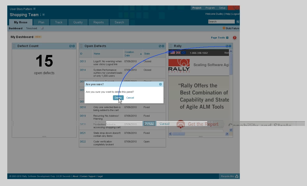

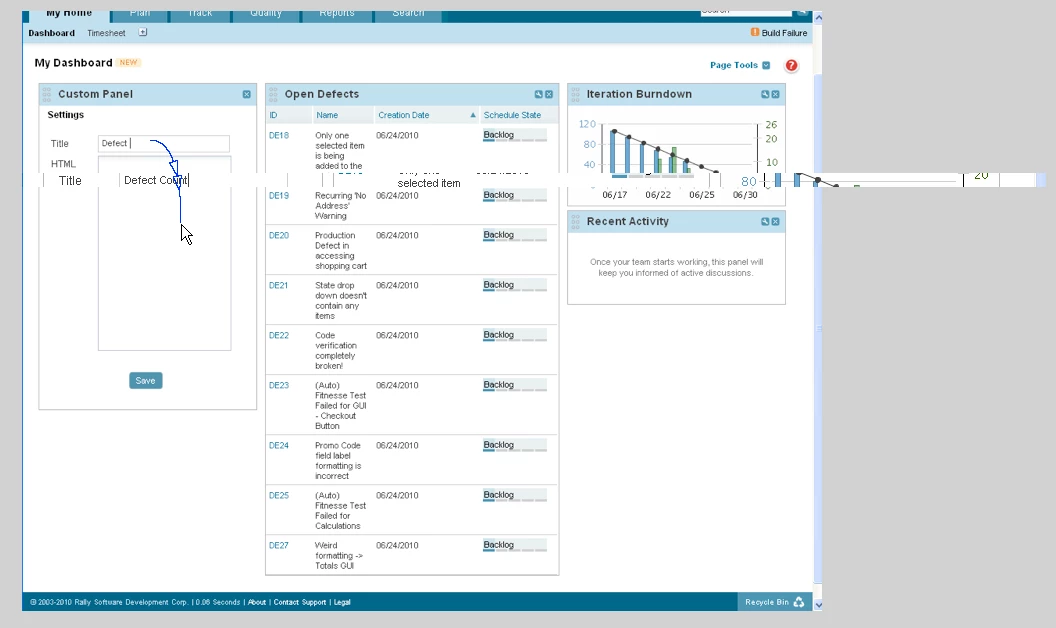

    I am having this same problem. It seems to happen more to certain files than others, though I cannot identify any suspicious correlations. The only way I can figure out how to fix this is to replace the typing with a text animate, which is far from ideal and never looks quite right.
    Even worse, this happens in areas of the presentation that have no animation or typing. I am attaching a screenshot for both examples.
