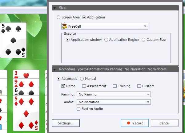

Aug 16, 2019 12:22 AM UTC
Hello Barb,
I am using the same ver of Captivate as you, but mine is working.
Check the setting:
I recorder ten minutes.
