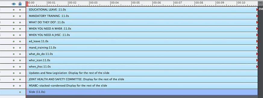

What are these (red triangles in the timeline to the right side of the image) and what do they mean?
And why do some have them and some dont?
Correct answer Lilybiri
This means that the end of the object timeline is attached to the end of the slide timeline. If you increase the duration of the slide, the object timeline will keep its lduration but the start point will move, because its end point is attached to the end of the slide.

Lilybiri
LilybiriCorrect answer
December 7, 2017
