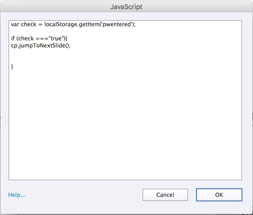

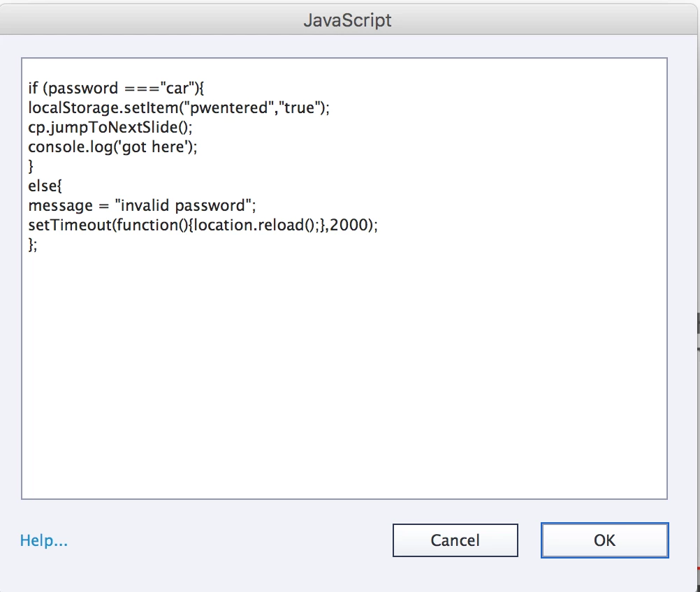

    Here are the 2 javascript window screenshots.
    This executes on entry of password slide
    This is the 2nd javascript window which is attached to text entry box that I have assigned the variable password too
    I added a little extra code here, when the user enters a wrong value I have a screen varaiable (message) that displays invalid entry for 2 seconds and then refreshes the browser for another try at the correct password.

    First off this was my error as I did the javascript from memory. my apologies  It should be localStorage.setItem() and localStorage.getItem().....sorry that's what I get for trusting my occasionally used code vocabulary from memory
    So here is a working example I put on my server.
    http://caleblinux.duckdns.org/pwexample
    I would be happy to email the captivate source file to you (I use CP 9) if that will help.  Here is a dropbox link to the .cptx file I created this with.
    Dropbox - pwexample .cptx
